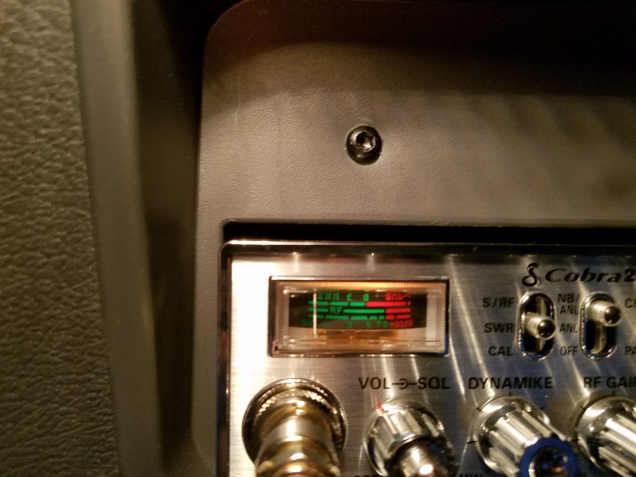

    Keyed up, calibrate setting:
    Keyed up, SWR setting:

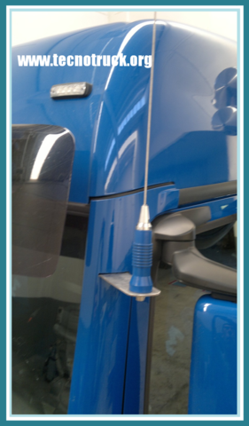

    This is how they do it in Europe.

    Well he aint in europe and those mounts do nothing for him on a crapcadia..Fresh coax(15' 2 or 4" i forget exact)..Cascadia mirror mount(not single stud style) and the longest ant you can get away with with tuneable tip..7 ft skip shooter there..Got pvc pipe on it to keep it from swayin to much..

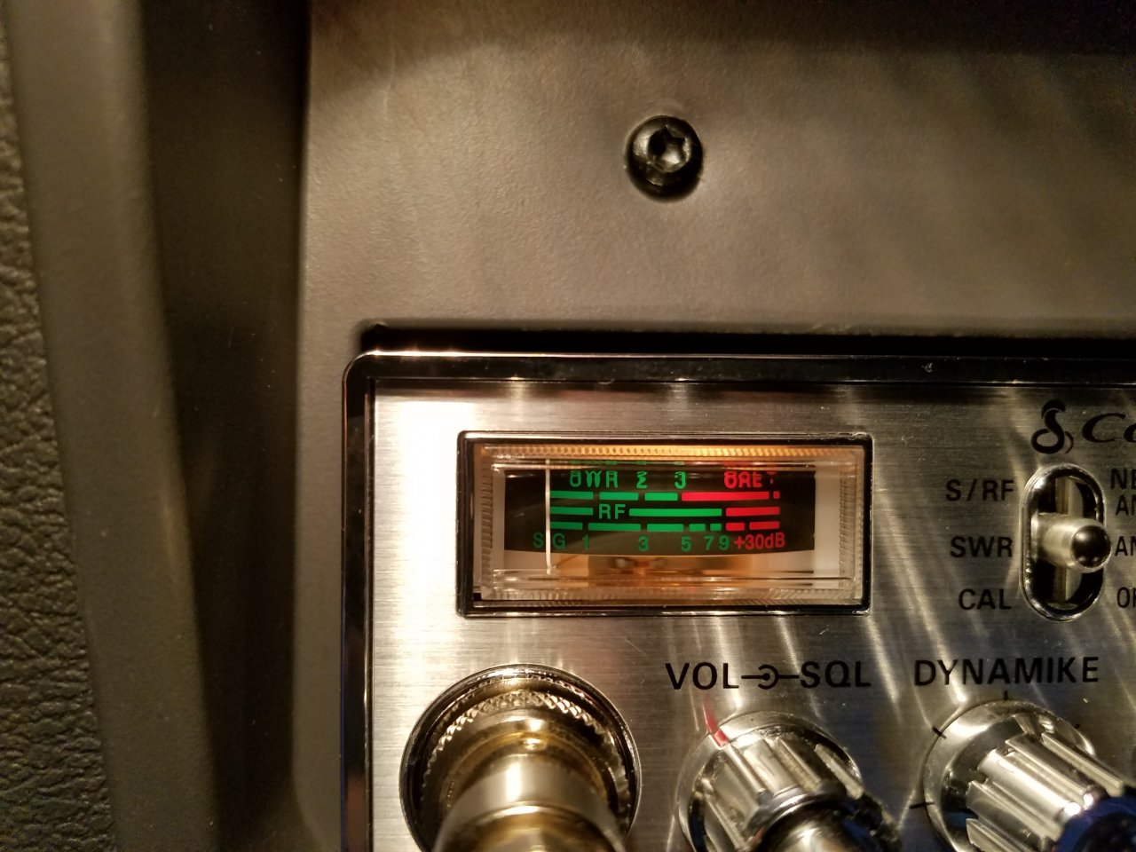

    I didn't want to go all the way yet, so I stuck with the 3' Francis for now, as well as the coax upgrade. These are my results right now. I have a friend's test meter, I just need to get a jump cable for it, then I can fine tune. I haven't had anyone I can talk to yet to test it out.
    SWR, channel 1:
    SWR, channel 40:
    Is there such a thing as getting the SWR too low?

    DO NOT use the internal meter.
    ALSO anything below 1.5 to 1 is good.

    Why shouldn't I use the internal meter?

    Accuracy which the internal meter is not. Find someone with a RIG EXPERT or at the very least a MFJ ANALYSER to check your SWRS
