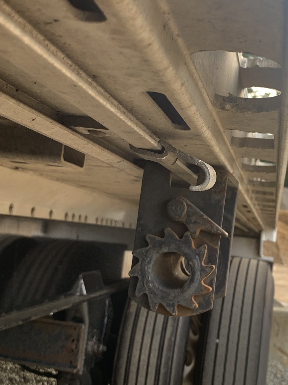

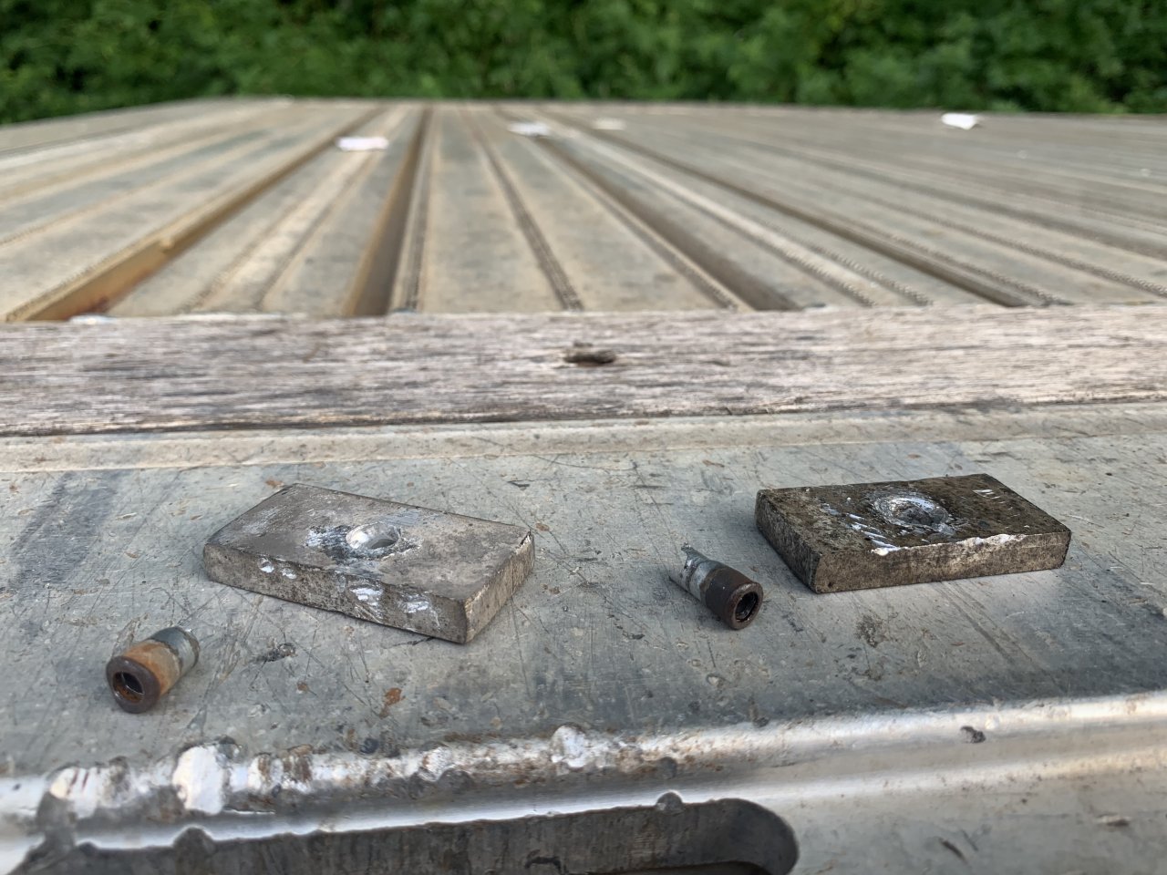

    I'm half blind but it looks like a torq head bolt that someone stripped out. If not then its a rivet. Either way grind the head off and use a punch to pop the rest out. No big deal.

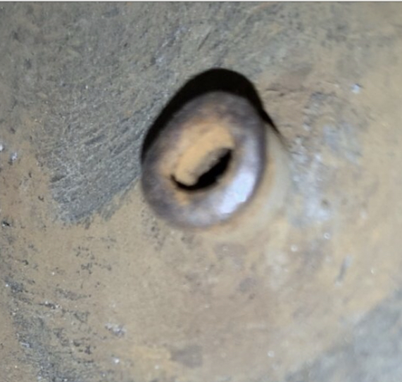

    It’s a rivet there’s nothing welded. It’s an aluminum trailer with a steel rivet. It’s rusty and you can see where it’s distorted from being crushed. 4D889642-40F2-4929-ADB1-276AE9EB06FE.jpeg A186E2B0-3E84-4FC6-90F8-0ACC03F97B6A.jpeg

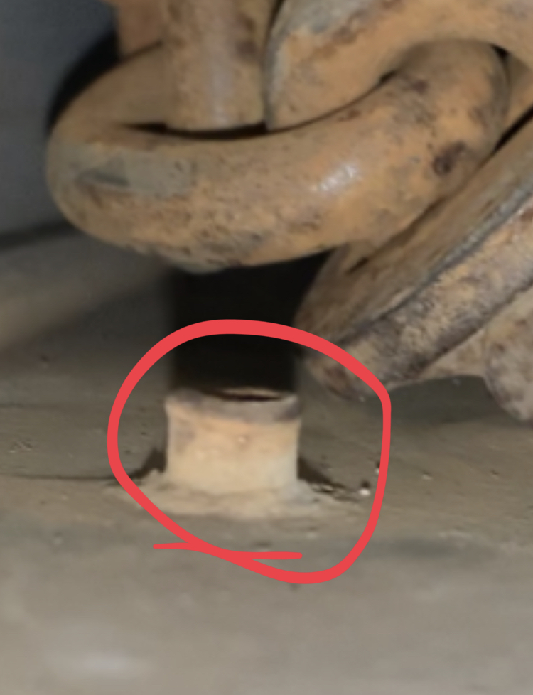

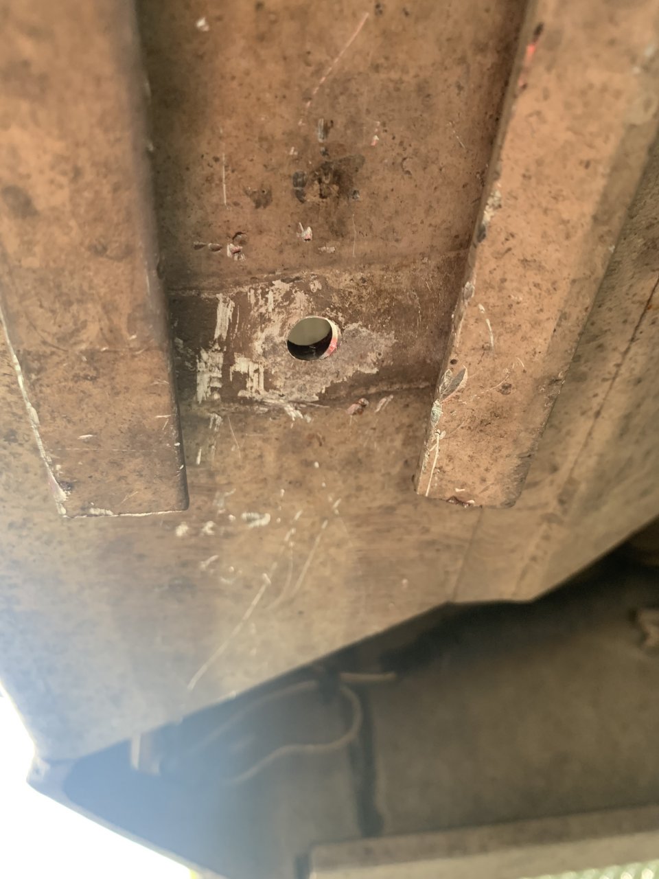

    Yes Johndeere420 was correct. It’s a rivet. What a stupid design. Do they just expect who ever to fine with what they gave from factor
    To make matters worst, the blocks stoping from going over the trailer wheels are also riveted..
    In the front I can easily get a nut and bolt to replace rivet. But the rear has no opening for me to do so. So I haven’t touch it as yet until I can find a bolt that van probbaly just screws into the rivet whole

    I'd just remove the ones back by the trailer wheels. Those are there to prevent company drivers that dont care from putting a winch directly over the tire.
