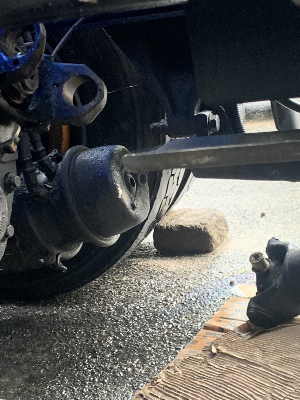

    Basically It wouldn't budge with my hammer and punch, the caps are like stuck. I'll try my sledge out sometime just didn't have it. I reason I am doing this is to do a yoke pinion seal.

    Got it off. Just jacked it up from under and it came free!

    This reply is for others. Be sure the jack is not positioned where it could possibly bend the tube. The reason for chalking the front wheels is because the truck can roll when you have all rear tires off the ground. In the dark on the side of the road I found I was in that situation. Tapping on the yoke ( worked well previously ) did not work. I put some heat on the yoke and it blew out with an explosion.
    You never want all the rears off the ground or that much pressure on the input bearing. However if you get the tires a little light on a grade it may want to slide.

    Nice hole drilled in your frame flange. Next time, move jack more to the weld on the yoke on the driveshaft. Glad you were successful.

    Beat me to it lol. Sketchy!
