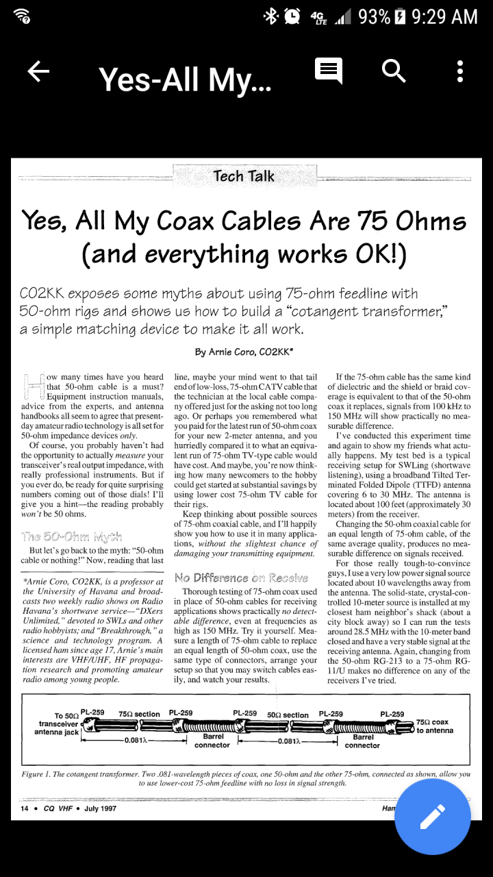

  9. rabbiporkchop
    9,678
    6,548
    Feb 9, 2012
    Wapwallopen, Pa
    Are you sure about that?
    Yes, all my Coax Cables are 75 Ohms
    You can use any kind of coaxial cable you want and it doesn't matter what impedance the cable is if you know what you're doing.
