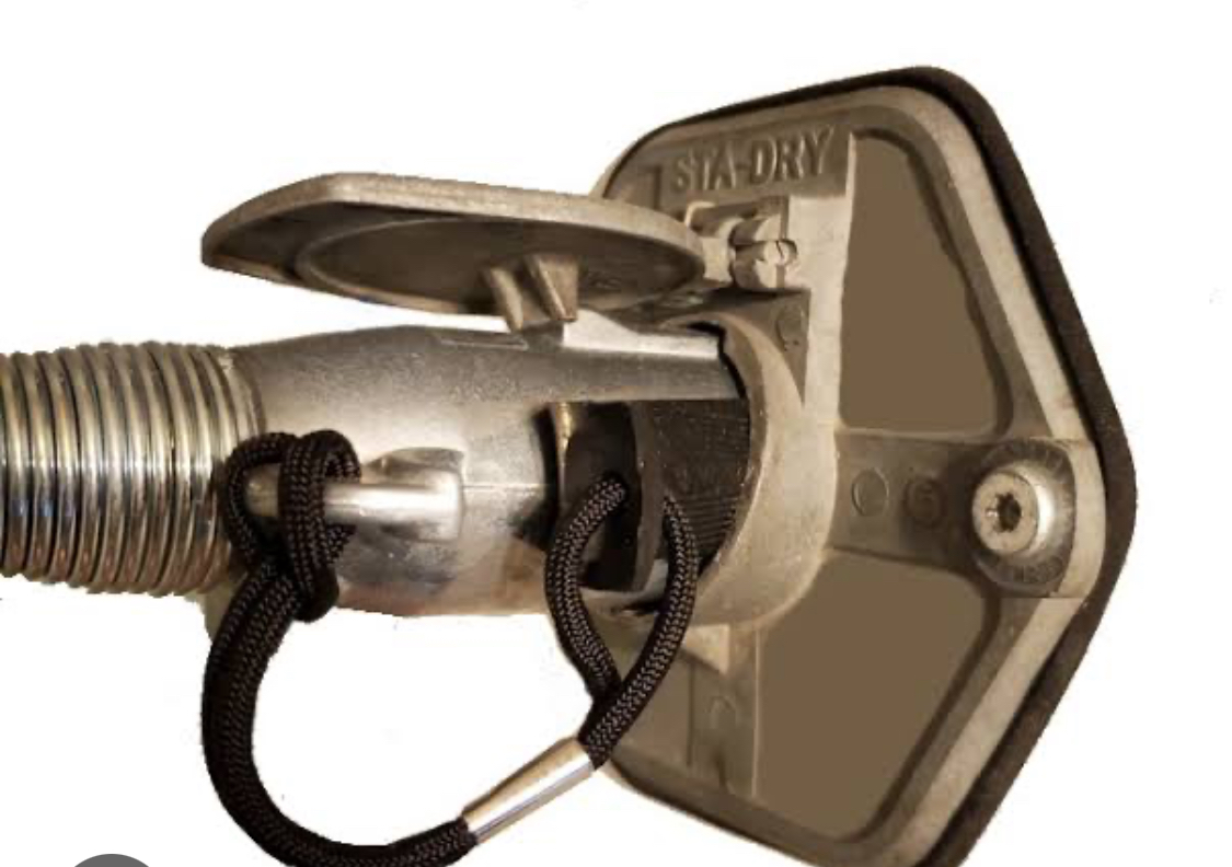

    Check the prongs on the trailer. And like already mentioned, could be a ground issue on the trailer. Wiggle the light cord at the end. I bought this tool that has help for electrical issues to get you by. IMG_7197.jpeg IMG_7198.jpeg

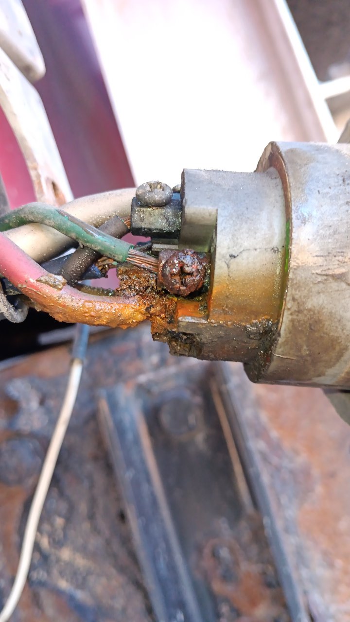

    Probably something like this going on in that trailer
  7. blanusatransport
    blanusatransport Bobtail Member
    2
    Feb 11, 2025
    Yea I pulled out the plug and it had a decent amount of corrosion on it, went and bought a new one was going to rewire it up, maybe that’ll do the trick.
