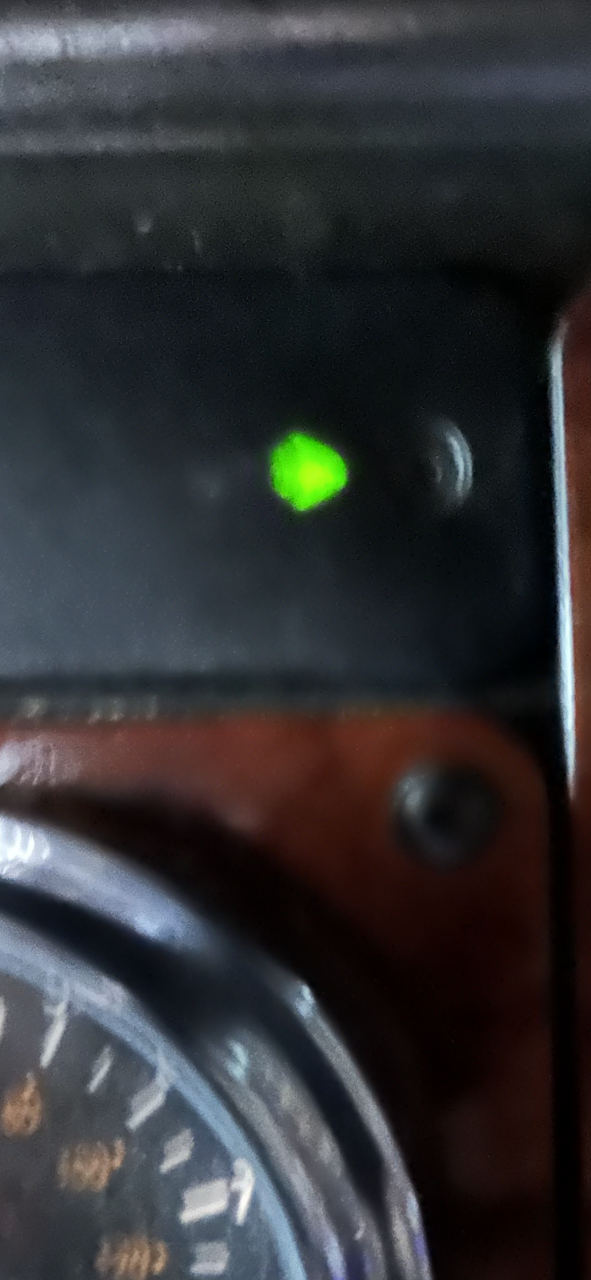

    Been having this problem for a while. My right turn signal indicator light will illuminate very weak, and fade on and off. Only happens when the headlights are on, and only when my Trailers hooked up, (plugged in). It has always went away before, now it’s constant. No right turn signal at all with lights on, and Trailer plugged in. Also no 4 ways. Only the full time indicator. Turn lights off, everything works normal. Unplug Trailer, everything on Truck works normal, with lights on or off. I took the switch apart, stretched the springs out, checked the points, greased it up. Good as new. Problem still exists. Using a test light, I checked the pigtail and 7 pin receptacle on Trailer. Everything’s working right. Checked the plug for right side Tail lights on the Trailer. All good. Thought maybe the light itself was shorted out. Swapped another tail lamp, still the same. It’s as if the right side running light wire on the Trailer is shorting out the turn signal wire, since it only does it when headlights or running lights are on. Similar problems with right turn signal have always been fixed by rebuilding the switch. Sometimes simply by unplugging it and plugging it back in. A mechanic suggested that on my last Truck. Said he doesn’t know why, but they’ve found it works. It did. Had to do that a couple times on my last 99 Classic. This ones a 2000. I originally figured it was in the Trailer, since it only does it when plugged in, but it checks out. Test light shows the same results at the tail light plug, with or without the lights on. I’m at a loss.

    I’m not sure. I think so. I did some more guessing. Now when I turn the right signal on, all 4 rear trailer lights come on Lol. I think it’s in the 7 pin receptacle on the trailer. The pig tail checks out. With or without lights on. But when it’s plugged in, with lights on, and right turn signal on, all 4 trailer lights blink, and everything on the receptacle lights up except brakes. It’s the type with circuit breakers. I’ll get a new one tomorrow. Nothing’s available today. Hopefully won’t get shut down for it. Turn signals are required lighting.
