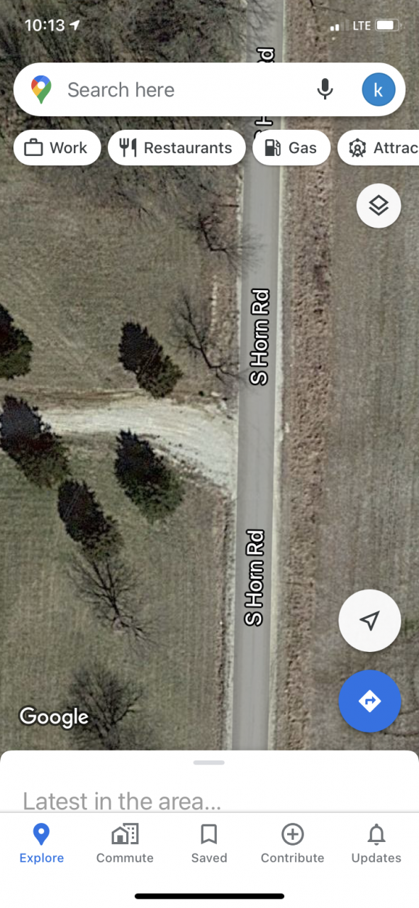

    You put a truck and flatbed into that driveway? That’s pretty impressive. I have a 45’ wide driveway and turn off a 20’ wide road. I can just barely make it with my 48’ double drop. 21EFCAEB-AB1F-4E3C-9483-0F304D731838.png

    I have to use my dump valve to get in there, so my trailer behaves like it's only 38' long. Makes it a lot easier than it looks. I did manage to blindside back in there without the dump valve once, but I could never do it again. I even put my drone in the air, and I still couldn't do it. Problem is trying to stay on the road and out of the neighbor's yard.

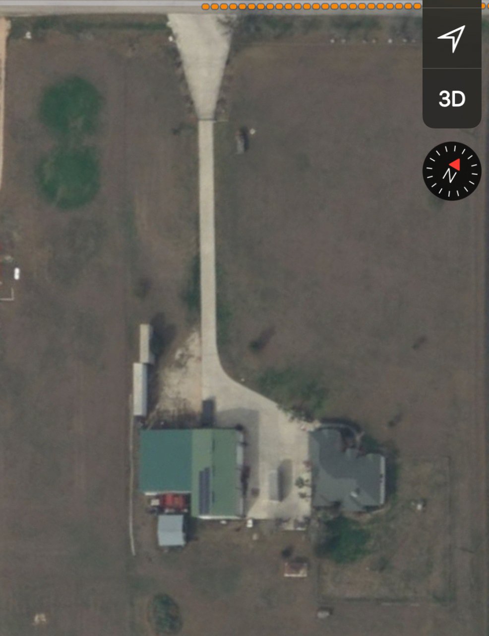

    Gate is 14’ wide set back 75’ from road. Can park two trucks with a pickup in between them in the flared part safely off of the road with the gate closed. To get idea of scale the two trailers on left of shop are a 48’ and a 38’ and a 36’ sitting between shop and house.
    I can either pull straight into and drive through the shop or turn hard right halfway down the drive and then back up anywhere else need be. It is hard packed coastal grass covered 3/4 base.
    The flare at the road makes all the difference in the world. No wide swing necessary and opens it up for vision. There is a 90 degree bend in the old road 700 ft down at north corner of property that is blind and people fly through it.

    That setup is horrible. But out of the goodness of my heart I'll take it off your hands, cheap yes but you'll be rid of your nightmare.;)
    A pond and more trees and you'll have a lil slice of heaven there.

    I'd kill to have your setup.
