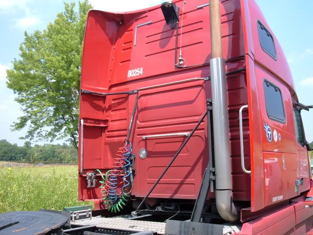

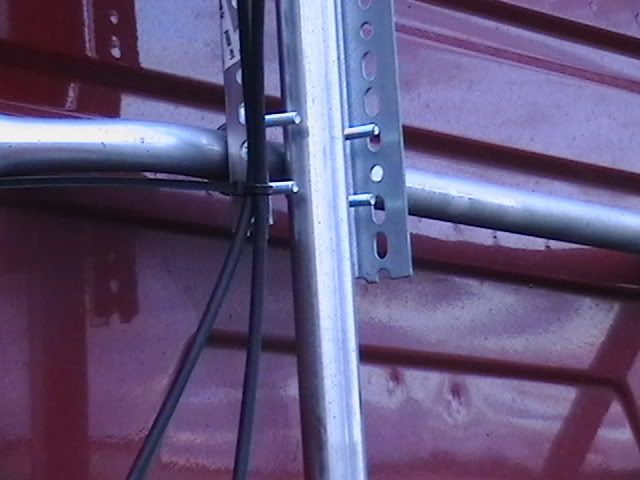

    this is the setup i did on the last company truck we had..... it's a NO DRILL install
    the parts
    the install
    i drilled out the welds holding the arm and replaced then with a carriage bolds so the arm can fold down
    finished and no one can park next to me and block the dish. it can see over my trailer or truck, from the time i'm park to having it set up is less than 5min and take down time is under 2 min and i don't have to store a wet, dirty dish in the truck
    dish charges me $12 a month only because i have a extra box and the extra box is a 2 tv dvr so when i'm sleeping i can record 2 shows at the same time upto 20hr's recorded in a 10 break that i can watch later.... i had the dish and the box leftover from when we upgraded the house to hd
    total price for the unstall was under $120, the mast was $85 @ iowa 80 the dish kit for the mast was $25 the rest was around $12 at home depot. the wires run under the sleeper and in thru the same hole the invertor wires used
