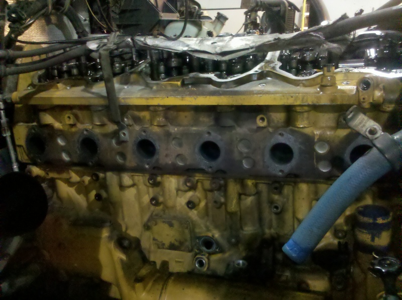

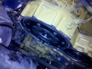

    You cant just go to a single turbo on a acert.It will build too high of egts because of the actuaters.You will have to remove them,cut the spacer,change the ecm,pull the water cooler,replace wiring harness,replace timing gear,and change timing sensor location.It runs in the mid teens.
