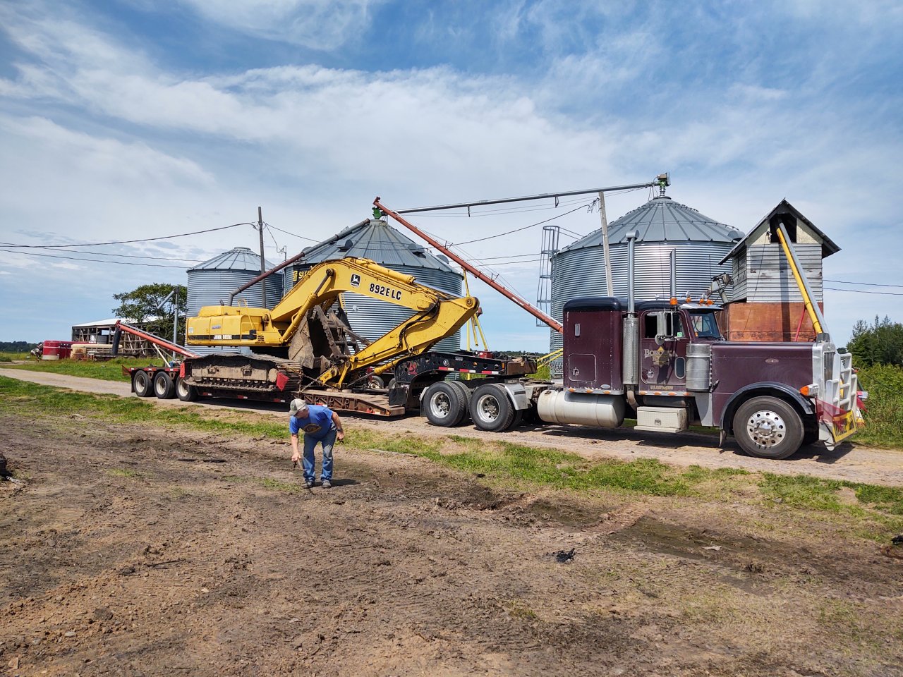

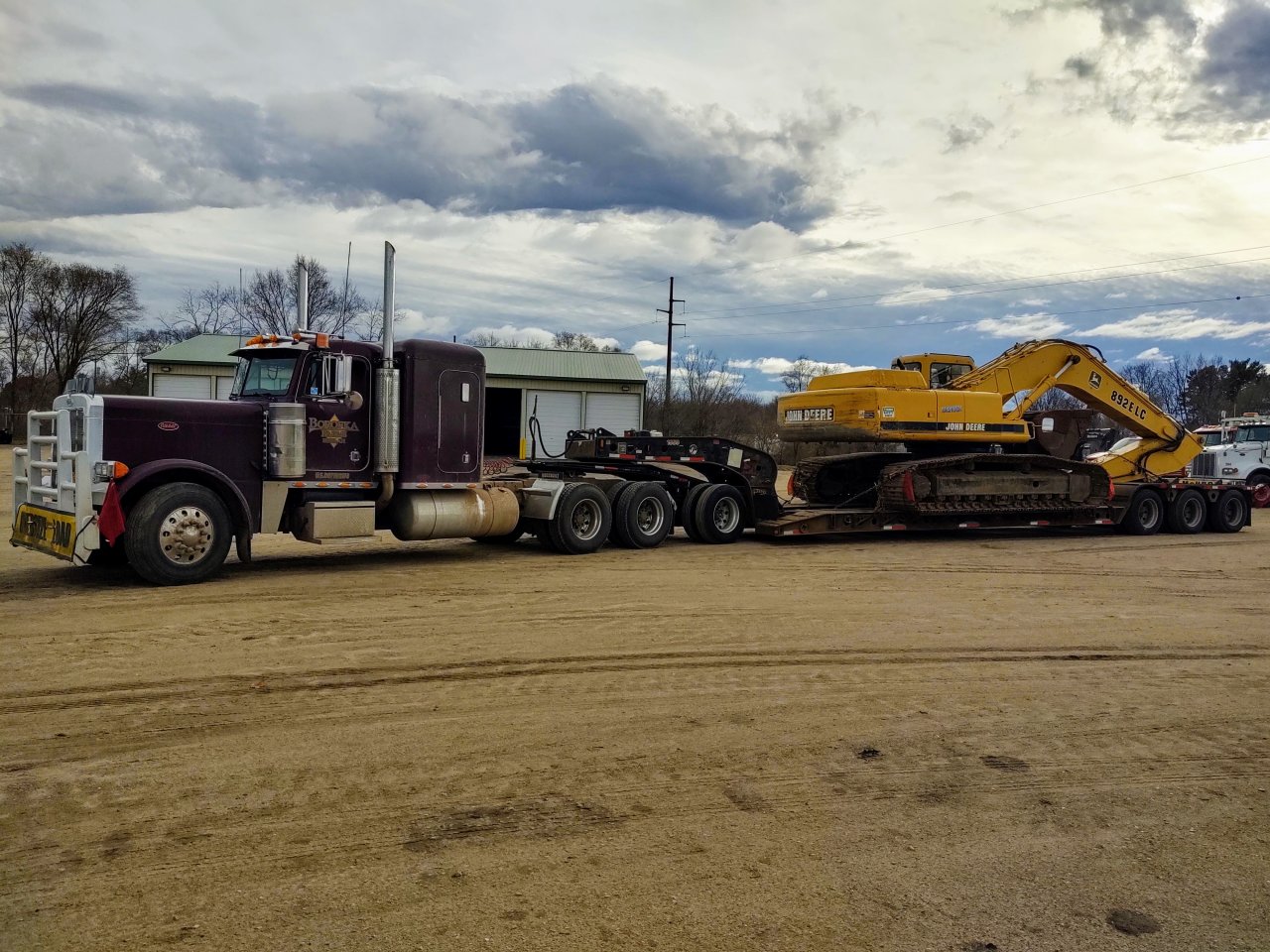

    I use a single axle jeep for much the same reasons as you are mentioning. It's a pain in the ### but it works. IMG_20191126_140001059_HDR.jpg
    An old antique close coupled tandem jeep might somewhat split the weight with your short neck trailer. But then you loose the ability to jump it on the tractor frame or chain it to the neck to get out of job sites like a single axle can.
    If you can get away loading a hoe backwards it's a whole lot easier not messing with a jeep doing short job site moves! IMG_20200819_122020238_HDR.jpg
