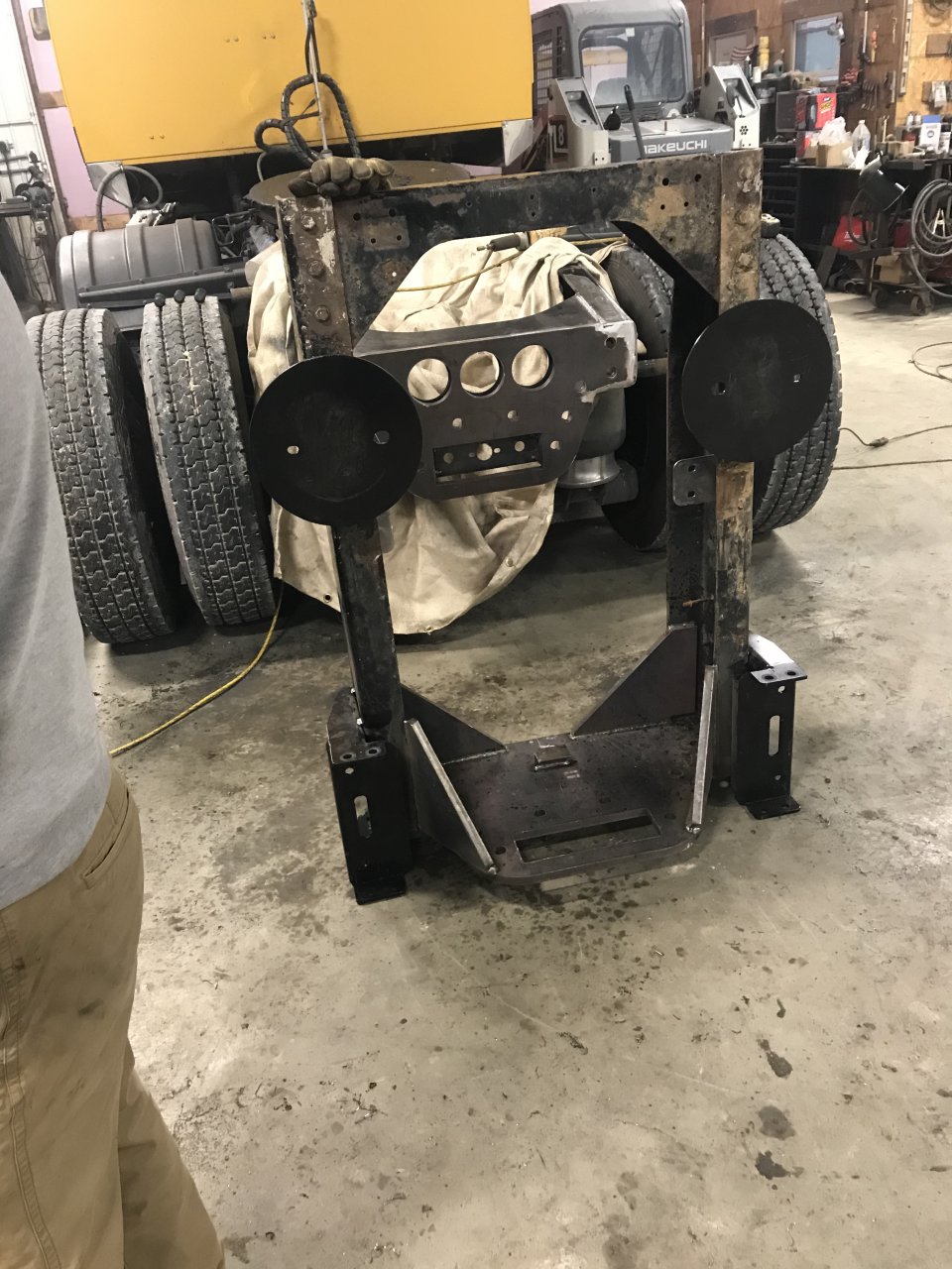

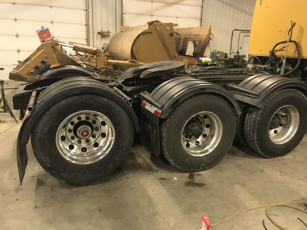

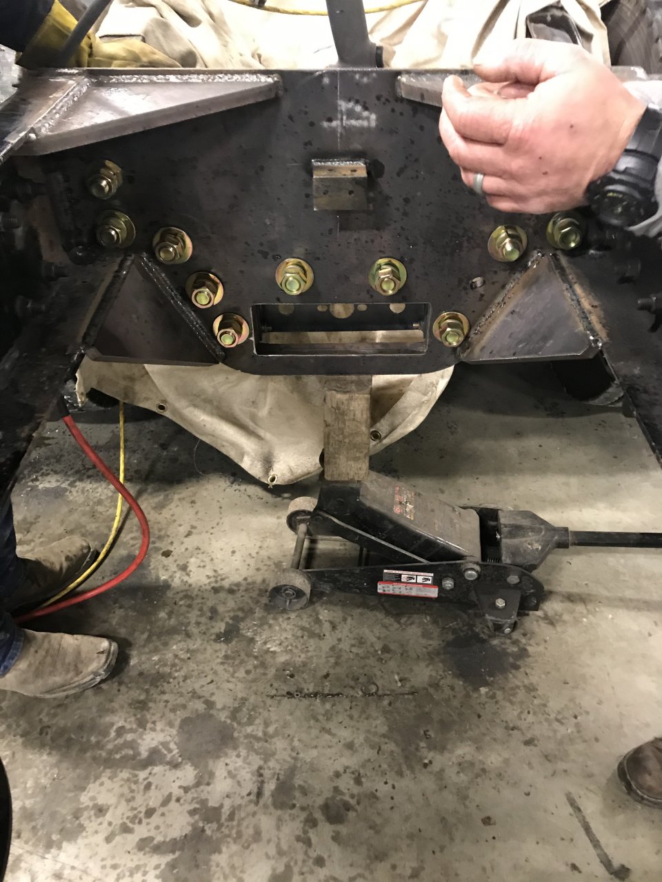

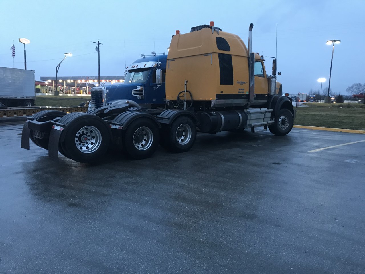

    I built a pin-on tag axle for my last truck. It worked fine but I still needed a long neck rgn to reach the fifth wheel because you can slide the fifth wheel back onto the pin-on axle

    Would there not be a way to build a pusher axle forward of the drives, that is removable in the off season when you don’t need it ?

  4. Landincoldfire
    Landincoldfire Heavy Load Member
    933
    5,199
    Sep 27, 2015
    New Holland, Pa
    Nah, it would be more of a pain to take off and would weigh more than a conventional pusher.
    cke Thanks this.
  5. roundhouse
    roundhouse Road Train Member
    3,213
    7,340
    Jul 11, 2018
    You could remove the wheels and brakes in the off season, leaving just the axle and airbags. That would leave , what, about 1000 1200 lbs for the empty axle and bags ?
    cke Thanks this.
