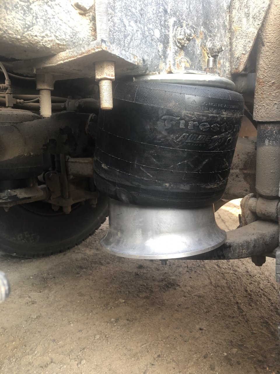

    The U-bolts have come loose and the spring (I think) has dropped or twisted causing the air bag to look crooked.

    That’s how mine looked when the torsion bar mounting ear broke, U bolts never loosened up, good time to inspect and change the torsion bar(s) if needed. I guess you know, U bolts are a one time use item, once they’re stretched when properly torqued, they supposedly can’t be re used, because they won’t stay tight. Good luck, lining it up. We used a bottle jack, along with floor jack on mine, when the torsion rod ear broke. It can be done that way, one at a time. But if you’re doing them all, with torque rod disconnected, I guess it doesn’t matter. I’m Leary of dropping the whole axle, and lining it up. If you have the means though, probably best. Good Luck.Be safe.

    You surely know you have something else going on there. Normally a pin between the axle housing and spring or bracket maintain alignment. You need you look a little deeper while you are working on that.

    Yes, I’ll be taking it apart to see what’s wrong.
    All the other bags are straight and good.
    Truck only has 405,000 kms on it.

    Looks like a new air bag. Maybe it’s installed wrong. They have dimples on the top that align with the bracket, and a lot of wiggle room for adjustment. That’s looks pretty extreme though. Was the old one that way?
