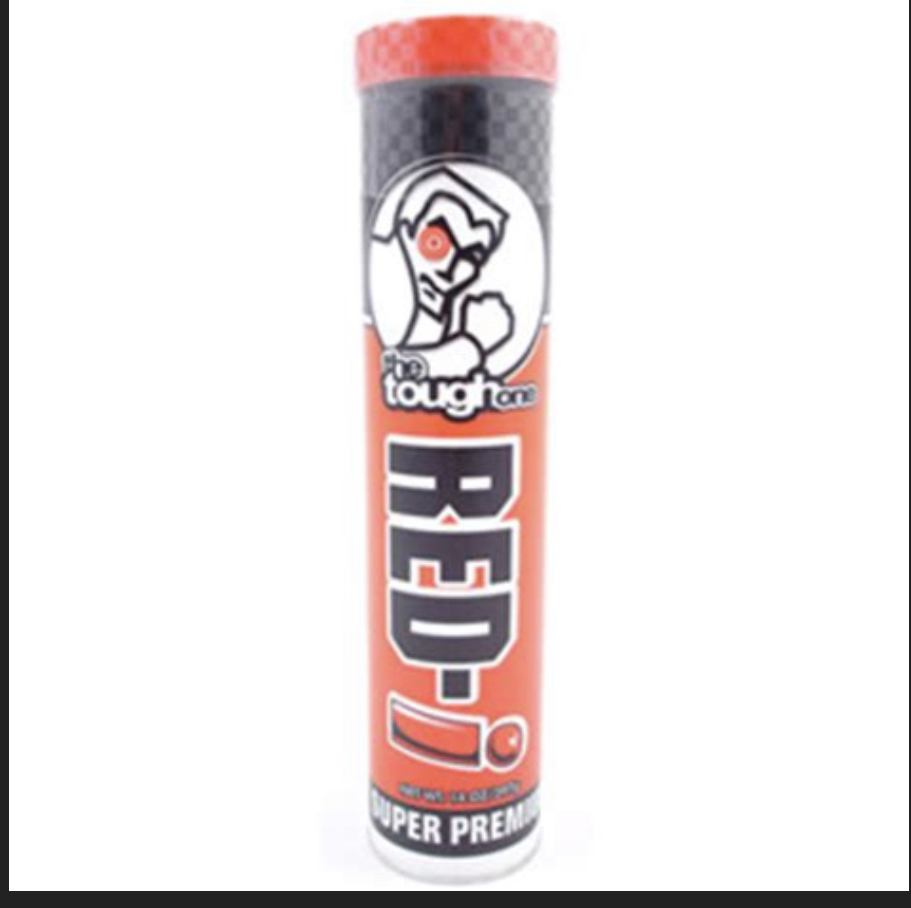

  11. Diesel Dave
    9,806
    34,002
    Jan 20, 2010
    Hesperia, Ca.
    I guess I’m over greasing mine, cuz I do mine every 5k with this. It’s my equipment and I have that piece of mind. I do a lot of construction sites.
