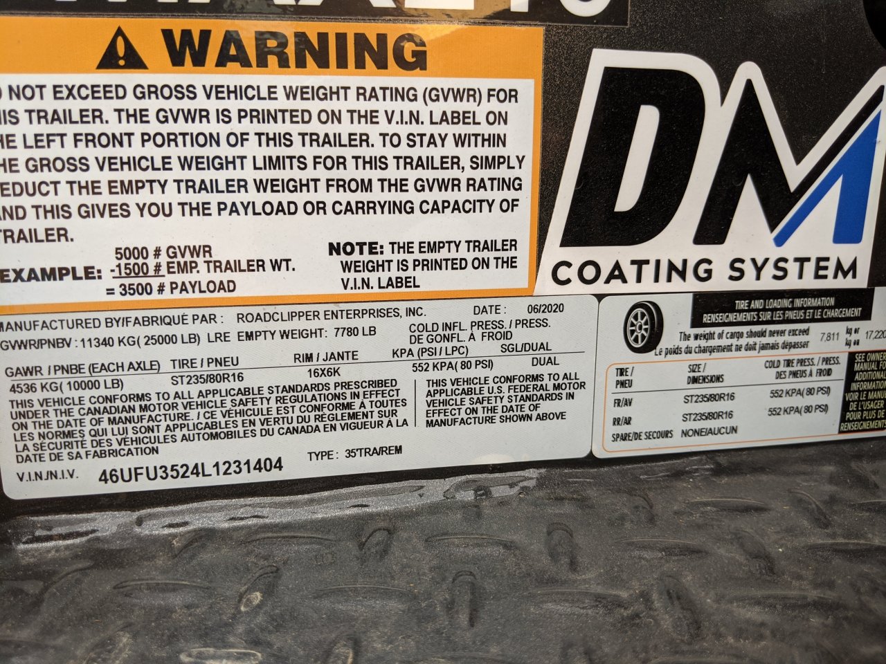

    My trailer has 2x10k with 14 ply and rated for 24k. I'll post a pic of the vin sticker later today, don't know how to do it on the phone.

    25k with 10 ply tires.
    Now, i don't run 10 ply tires, i run 14s on this rig, and I agree that one should not push the limits on ratings, both truck and trailer. And i don't. I just like to have that extra wiggle room if it's easily obtainable.
