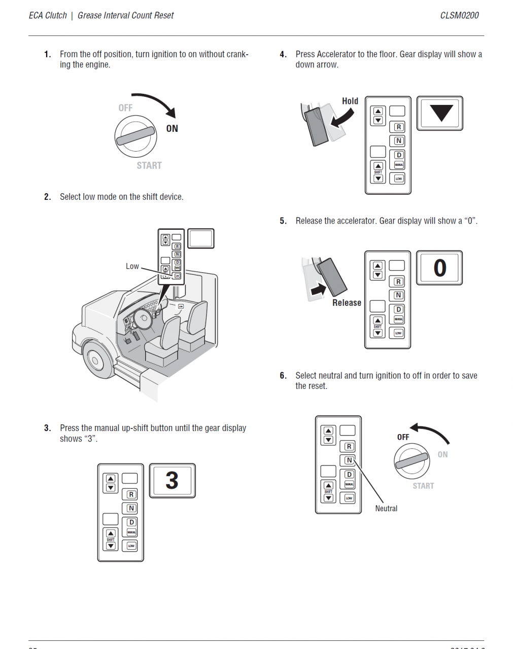

    got a 2019 LT with the eaton ultrashift 13 speed. The GI warning came on, I checked it out and greased the the cross shaft and release bearing. Question is, can this warning be reset without taking it to the dealer ?
  3. Heavyd

    Thanks, I'll give it a try Monday when I get back in the truck

    heavyd, it seems that the manual reset had not been set up. got to take it to the dealer to get it done.
    thanks again for the help

    I can't seem to find anything else, since you probably have the column style shifter, you might not be able to get that sequence to work. So you might have to visit someone with Service Ranger 4 software to reset that.
