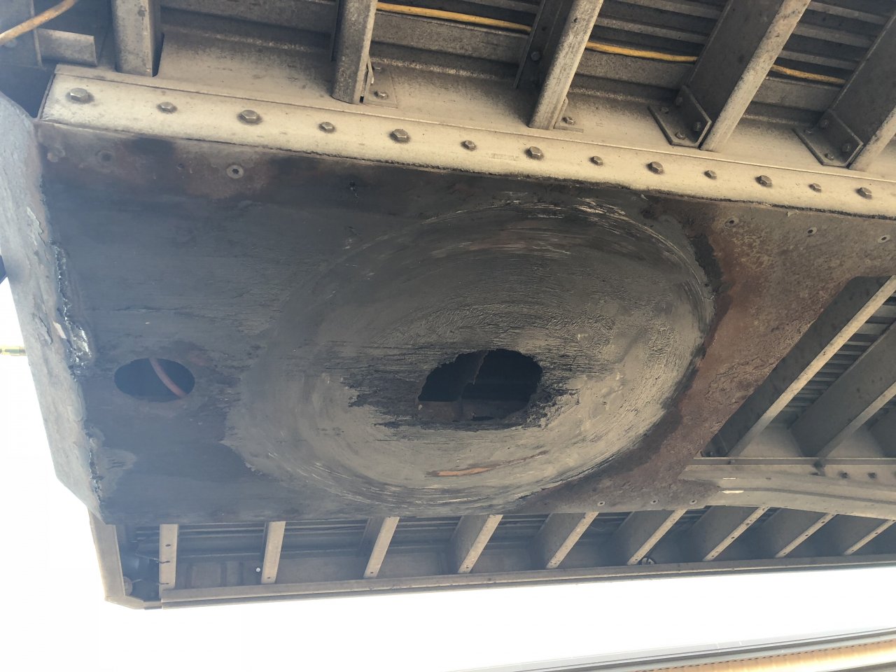

    Look at the bolster plate and kingpin. Get a welding chipping hammer and test it. It is probably thin and rusted through. The grease will cover up some holes that the fifth wheel may have already broke through.
    Buddy of mine had a 1990 Reitnouer 48x102 spread that he put around 2 million on. He had to replace the whole plate back in 2008. The pin just about pulled out. Lots of crud gets trapped up in between the plate and the floor and being dissimilar steel and aluminum it naturally corrodes anyway. He had no problems with that trailer other than that. It was a great trailer still in great shape. Sold it in 2012 when he retired to another friend who is still running it. He hauled forklifts, crates of roofing slate, and walking floors and axles for a trailer manufacturer up in Texarkana, and heavy things of that nature. Always ran max weight and that trailer still has the arch in it today. The new owner still hauls prefab concrete products of all kinds that will fit on it.

    My guess is it would look something close to this? 188A5470-62B9-497C-9CDE-DB46023269A2.jpeg 64AAD206-858C-4784-88D4-212C15703DC7.jpeg
