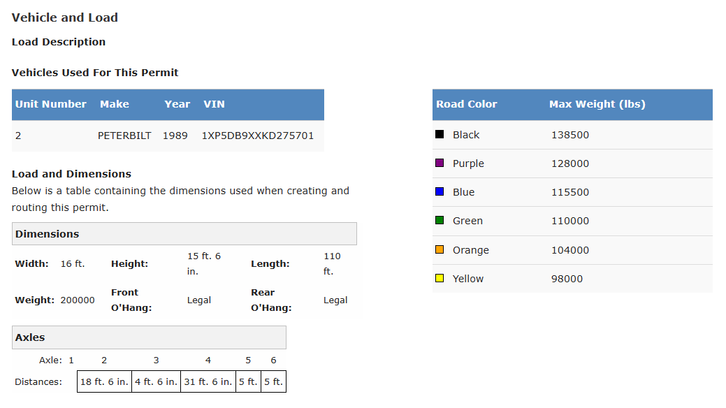

    We have an annual permit that allows up to specified width, height, length, and weight, and it varies depending on which road we are running.
    We have a four axle tractor and 50 ton three axle trailer, and our tare is about 42,000 lbs. We also have a three axle tractor that we can pull the same lowboy with. Here is our permit for the 3 axle tractor: upload_2025-2-2_17-2-44.png
    As you can see, we are allowed various weights depending on the road. We also have a max that we are allowed to go on an axle group (trailer, drives, steer). Many states are different, so you will have to learn what your area allows. It should be available on the State's permitting website. We printed up sheets so that anytime we haul something and have a chance to weigh it we write down the position of the piece of equipment on the deck, how far forward or back, finals forward or back, etc. We don't haul equipment other than our own often, so we can get it pretty dialed in as to what every load weighs, and how it axles out.

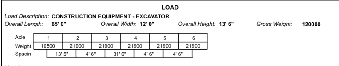

    Man I really appreciate the reply! I wish I did have the opportunity to weigh the stuff I haul but where we haul to theirs never a scale sadly. No one has really given my an answer or really explained it they just tell me where to put it on the trailer. I just have a hard time understanding where they get the numbers for each axle on the permits and stuff. It just seems like the numbers on the permits that attach seem like really low numbers.

    Maryland has no issue unless you exceed 27,000lbs an axle.
