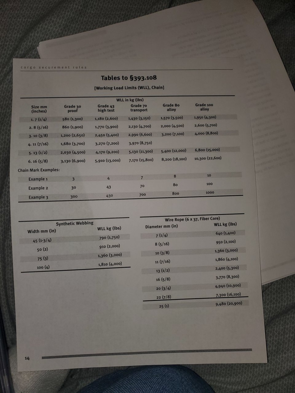

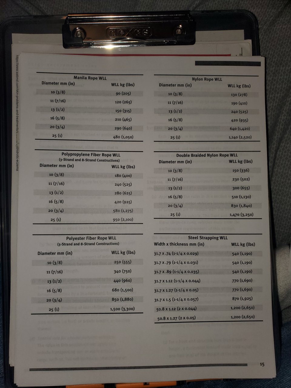

    This is why I ended up all confused. I tried to download this and read up on it, but I confused myself more!

    the first 2 pictures are just showing you what the working load limit is of each type of securement device... in flatbed you're gonna be using 4 inch straps. those are going to have a WLL of around 5k...what this means is one strap is going to secure 5k worth of freight .... the laws say you have to secure half the weight of the freight.. so if we have a load thats 1 piece and 10 feet long and weighs 40k pounds... we need 4 straps to be legal. make sense?

    Makes sense. 4 straps that the WLL rating is 5K equals half of the total weight of the cargo. One strap for every....a minimum of 2 straps for 10 feet of cargo regardless of weight. Anything over 10 feet requires 2 straps and then one strap per 10 feet after that regardless of weight? I think....please correct me if I'm not understanding this :)

    yes . you need 1 strap for every 10 feet of freight.. then if you dont have a bulkhead you need another strap up front, called a penalty strap..... so lets say you have a load thats 40ft long and no bulkhead. you will need 5 straps to be legal... obvious its always a good idea to throw more straps then needed.
