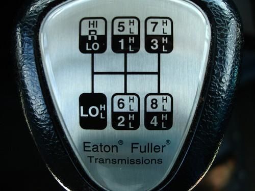

    Okay....I am kinda changing subjects for a minute BUT....can you please tell me what the far left bottom gear is on here? And I see the 16 gears....gears 1 through 8 have a high and low which makes for 16. Then the reverse high and low which is that like a higher speed for backing up and then a creep mode for reverse as well? The bottom far left one though I'm lost for words??? 1498178197.9601.jpg

    There’s 2 buttons on the shifter, 1 on the front side, and 1 on the left side you shift with your thumb… at least I do. Some of us call that the basement, mainly to get you rolling when loaded heavy. Split from Lo - Hi with the thumb button , then next shift you can split shift from Lo / H to 1 / L, then you have the option to shift / split all the way to high gear from there.
    Yes, you have 2 speeds in reverse. Hi not to be used unless Bob tailing or rolling empty in the Lo side then split up to the Hi side and slip back into reverse position, need to come out of reverse into neutral, shift to Hi then go back in to reverse. Takes some practice lol…
    Some of the older guys will know what I’m referring to here…. There was a time (was) we would pull 2 gears out of the LO hole position on the older 13 speeds. But only for short distance use only, like to finish topping a grade, just to keep from down shifting into the low side. Not that I’m recommending it be done…
