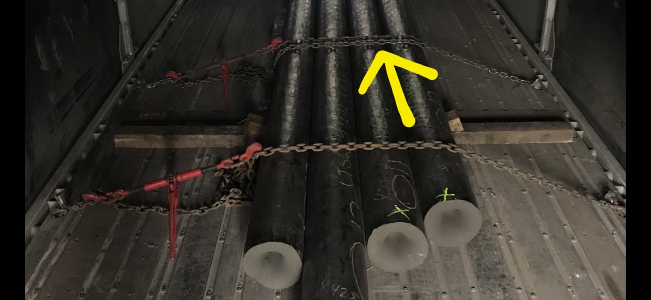

    Cheater pipe?? Is that literally what I search for online? Is that something that goes or fits with the winch bar for more leverage?

    Yes, but it is 1 chain wrapped all the way around. Helps tightened the load against itself as well as the trailer….

    Thank you BTW for the name of that tool....the winch bar!! :)

    lol… no, just a piece of pipe that will fit up over the winch bar, which would basically make it longer, giving you more torque against the winch itself. But I have seen longer winch bars that would give you that extra edge, without a cheater pipe…

    Like I said, sorry once again, I'm visual and the pic is great, but let me make sure 100% I know that we are on the same page....so pretty much you are going to put the chain under the load, wrap one side back over the load attach to trailer and the other will stay under the load
