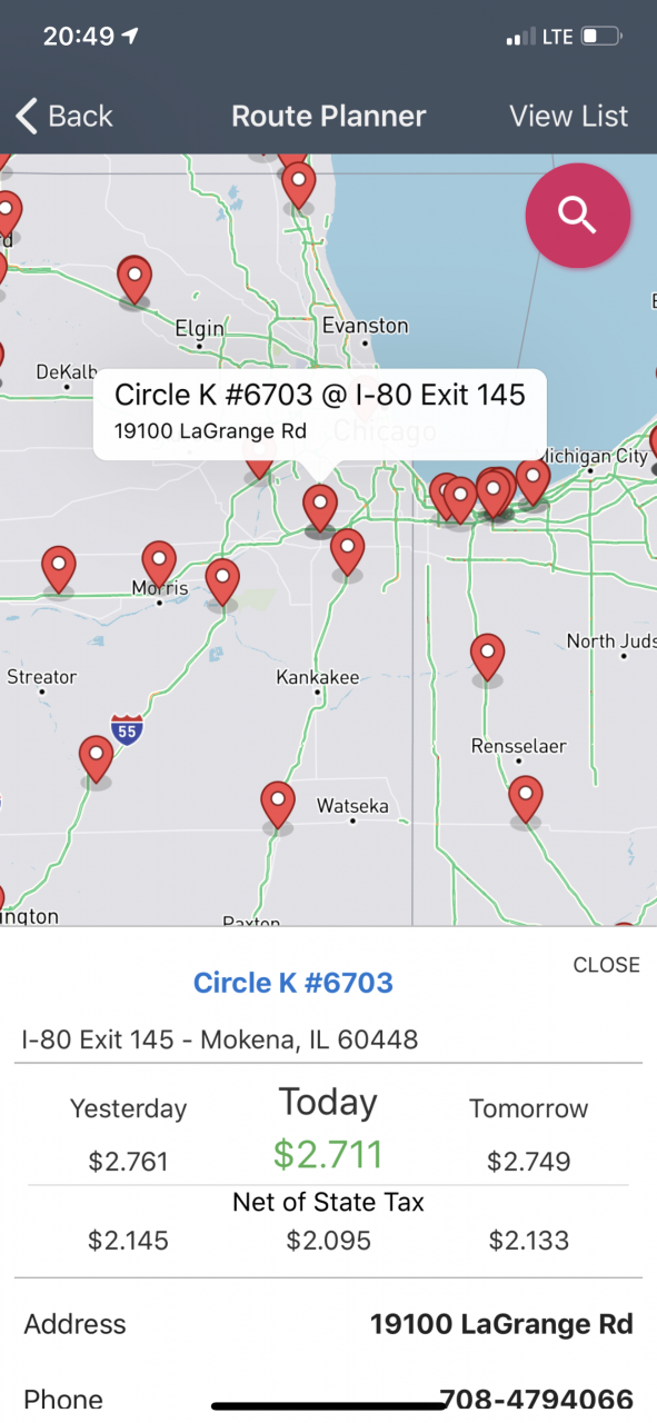

    The main thing that matters is to pay the lowest "rack price", the actual cost of diesel without taxes. What you have to pay in IFTA because you didn't buy enough in this or that state will be made up by the money you saved by paying the least for the fuel itself.

    Thanks I run a lot of IL but never buy fuel in IL price is too high lol

    The reason to check fuel without ifta included at your pump price. This is the lowest price and you're comparing apples to apples on the fuel price.

    IL has some of the cheapest fuel in the nation (without the IFTA tax). Sometimes I wonder if the Mafia is involved. Hahaha.

    Why are you paying someone to do your IFTA? If your state has electronic filing, it is very easy to do.Base price buying, probably already mentioned, is the way to buy your fuel. Pump price minus state tax, and any other fees. You may pay a little more at the pump, but it works out at the end of the quarter. Example. NC fuel is 2.69 with a tax of .362 per gallon. Va fuel price is 2.72 with .2020 per gallon plus a sur tax at filing time. Va fuel needs to be .16 to .17 cents per gallon cheaper to even consider. Hope this helps. In ancient times I used a recorder, voice not musical instrument, to call out the od reading as I crossed a border. Been buying my own fuel since 1990. Hope this helps.
