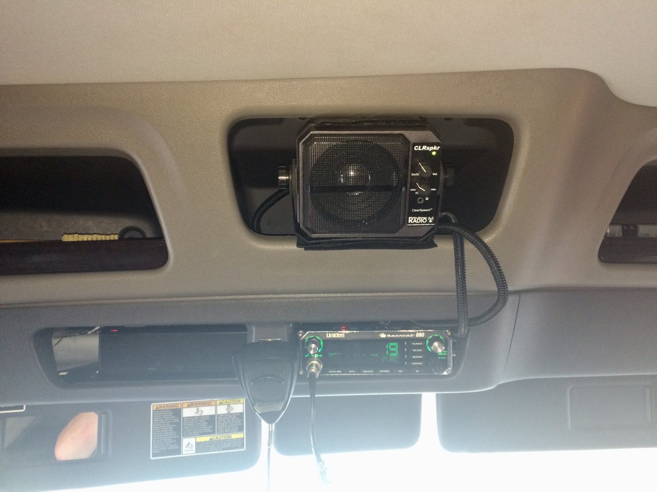

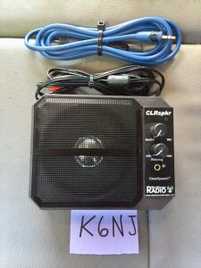

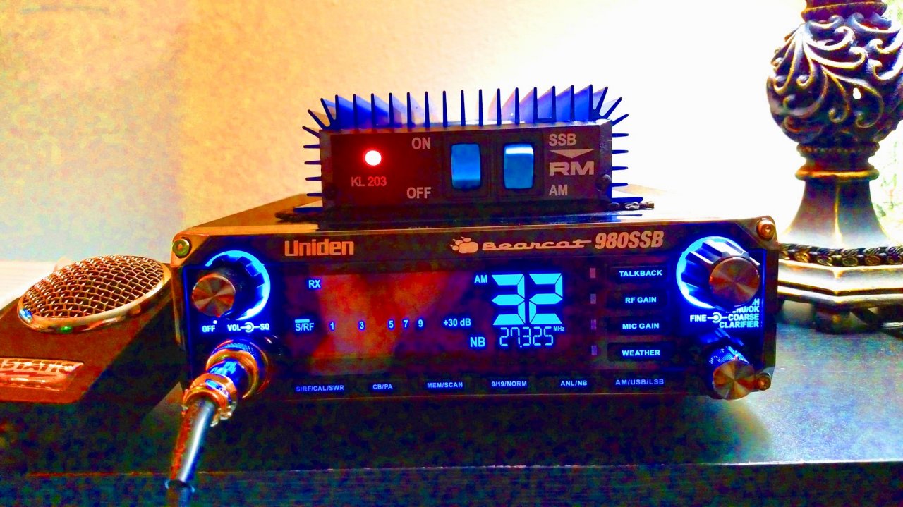

    Add the West Mountain Radio ClearSpeaker, boys. How many times I gotta tell ya?
    And then you add the KL203 amp which ALL runs off the same factory power outlet: radio, speaker & 75W amp off 15A circuit
    Hear & Get Heard
    Couldn’t be simpler or easier.
    Besides some bonding,
    Upgrade the coax (run it in flame resistant split loom). Seal all connectors.
    Add a CMC choke at antenna feedpoint. Add another (coax filter) at Radio end.
    A NAVONE 12V DC filter for power. More of the same split loom after an upgrade to amp wiring and Powerpole disconnects for all devices on same power harness.
    The speaker makes all those other changes worthwhile. (Same for upgraded radio.) The environment is too difficult.
    With the above I was seeing 75W forward & 1-w reflected from a pair of 7’ Skipshooters.
    Hey, you could have an N4 version of the RCI 2970. You “might” get out farther . . . but you won’t hear as much or as well without DSP.
    Of course, could move up to a YAESU FT991. If $1,200 is burning a hole in your pocket. DSP out the wazoo with buttons and sliders and menus. (Gotta take notes on the 47-settings).

    A higher fidelity mobile speaker is the:
    KENWOOD KES-5
    Used by public service, etc. Mil-Spec for tough environments. Reputedly better than the Motorola’s.
    About $50 with shipping. AND THEN an in-line DSP module. That’ll top your price quote.
    Look at it this way (as I’ve shown before).
    A nice used Yaesu or Alinco. $500 give or take.
    - 980 Uniden
    - RM ITALY KL203
    -WEST MOUNTAIN RADIO CLEARSPEAKER.
    $125 + $75 + $200
    $400
    Good luck coming close to this performance with a typical CB/Export. Won’t happen without some help.
    Until youse guys can clean up the noise with some DSP (can “hear around” what isn’t eliminated) you don’t know what you’re missing.
    Not for mobile. Too much noise generated by the truck.
    And all you do to alleviate that is MORE obvious with DSP.
