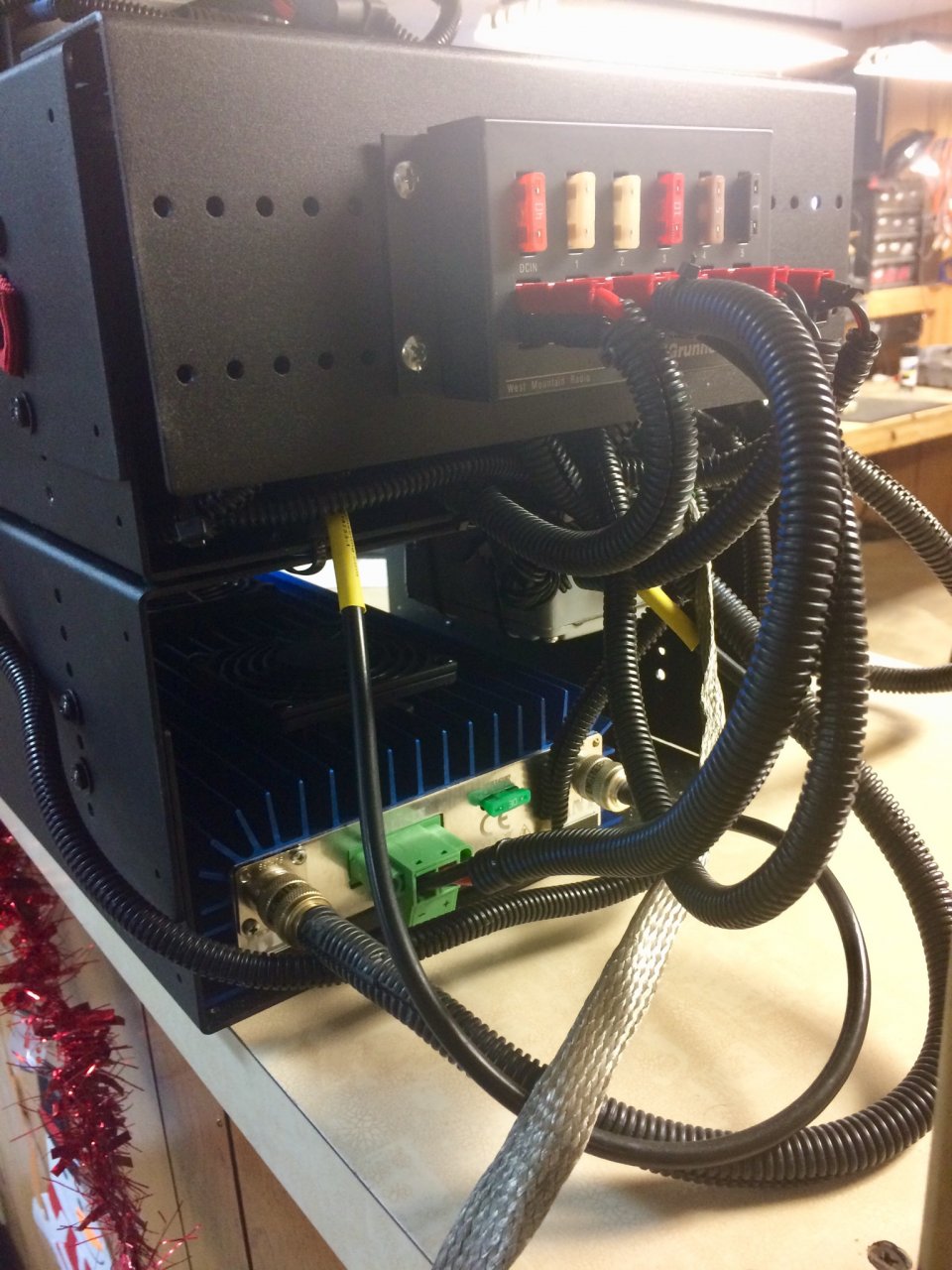

    6DBC65AC-F479-4E2D-9F7E-0675D06299A2.png 8A928AA0-B440-43DB-B8FB-A0F968B26533.jpeg 4E872C2E-0259-45FE-B7C4-080FCB5D20A9.jpeg FEA09740-67DB-40CE-8D61-5516D631ED6E.jpeg 3847291F-B8AA-4FF1-956F-2E9C7E7CF92D.jpeg 07CF7D18-7F45-4807-978B-F0C14CB5F6B8.jpeg 78D9A8DE-745B-4E8D-ABF6-2DA9FA38E9A9.jpeg F8083A8B-5569-43C5-B87F-FCA4DA72FC2E.jpeg
    Yes. Carried away. What you see there has been apart & back together a number of times. Not all is shown.
    Today have it broken apart again to fit the NIB Yaesu FT450D I recently acquired. Time to learn to use it a week or so before handing off to son home on rotation from Mid East.

    The TAC COMM TRC-1 Radio Carrier would be my choice for a passenger seat radio that fully encloses all gear I’ve advocated. The 980, amp, speaker, etc.
    The little RigRunner was my excuse to finally start using Anderson PowerPoles. (See POWERWERX).
    Have been using ANCOR Marine Grade wire and terminations since they started. (See WAYTEK).

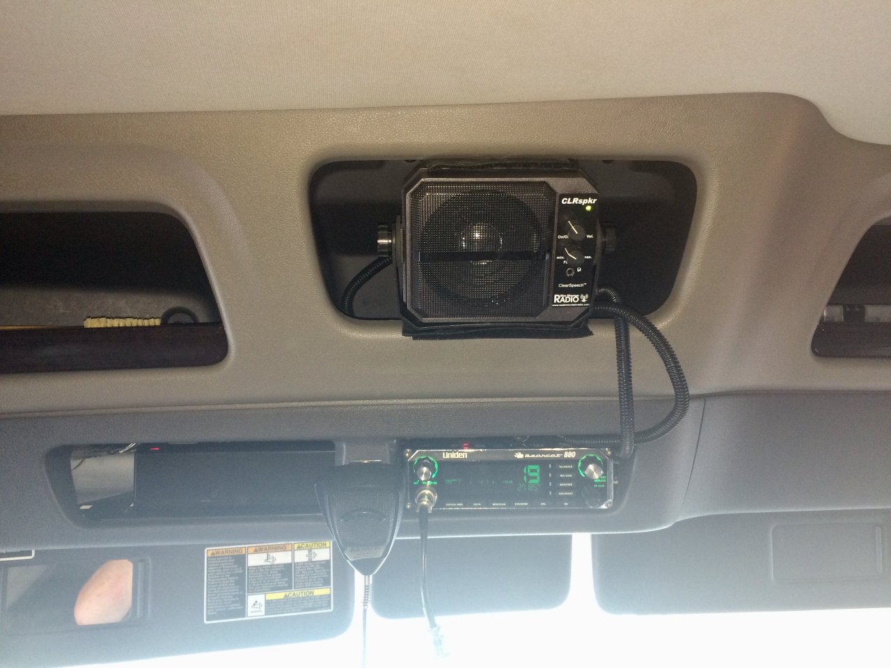

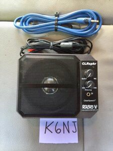

    The speaker will make more of a change.
    Hear, first. Transmit, second (if one wants an order of priority, IMO).
    In other words, use an SWR external meter on the F-stik.
    Check Coax for condition (ohmmeter). Replace with RG8X if not a terrible job.
    And clean power. Filter, and new leads to BATT. (Even a BANDIT filter helps some).
    (Power leads can get expensive for quality. Measure twice and order custom from POWERWERX).
    I used zip cord of 22’ in 10-ga paired in unequal lengths to mix and match those lengths to run power. Try several configurations
    Then speaker.
    Then amp & Skipshooter.
