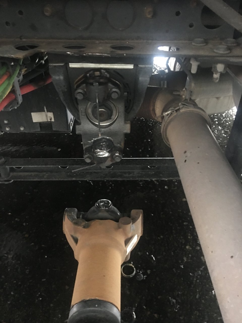

    Ok so what caused it to break then??

    I say a shock load. Universals just dont bust off at the base like that for no reason. The ends are not turned blue so heat wasnt the cause.

    Funny. After over 20 years being around trucks (10 of those as a mechanic) I have yet to see a u-joint on a heavy truck that is sealed. Every one of them that I have seen has had a grease fitting. Now the slip yoke is a different story. Some have a grease fitting, others are sealed. Seems to be about 50/50 on that.

    Do you have any close up photos of the break? If the surfaces of the breaks are mostly rough and jagged, I would say it was shock loaded. If most of the break looks smooth, almost like rippled sand on a beach then it was likely fatigued before it finally let go.
