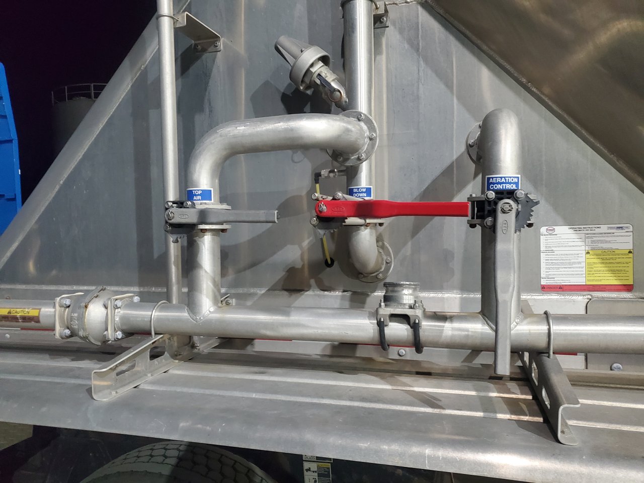

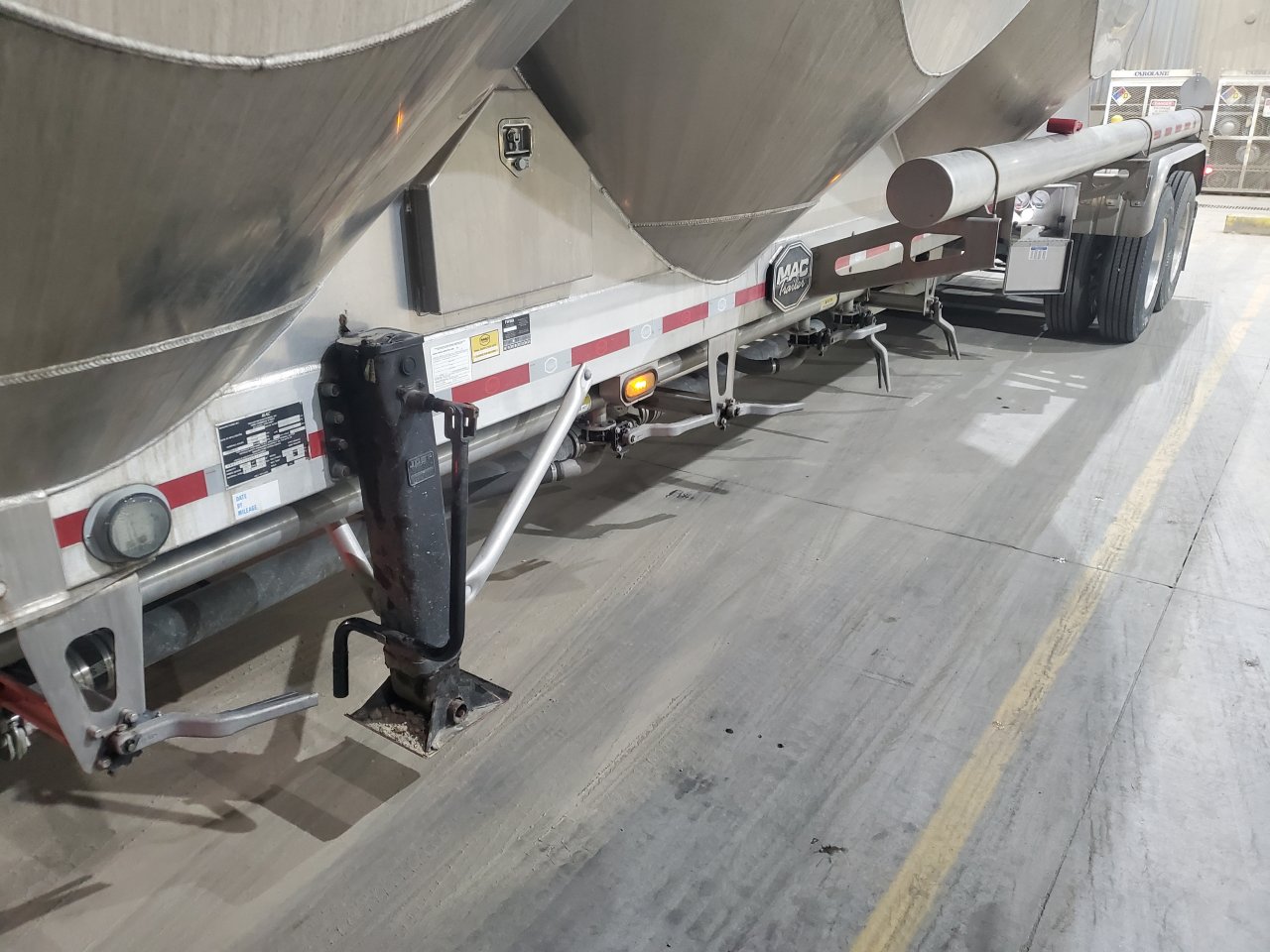

  8. auto293
    auto293 Bobtail Member
    5
    1
    Dec 10, 2019
    This is what my trailer looks like

    The easiest thing I can tell you, is start it up and build your pressure, 9/10 times we open our air assist ( the valve that feeds air to your product line, which is the one behind your front fender on your MAC trailer) to about halfway open, and then slowly open product valve, and see what the pressure does, it takes a minute or 2 to stabilize from your initial pressure drop and then either open it or close it a little bit at a time. This depends a lot on the trailer as well and how well its maintained and everything, some trailers you can have air closed almost all the way to maintain pressure, and some you have to open all the way or a lot more to keep pressure down. Its a learning curve with each trailer. I almost always go back and put a foot on hose just to feel what the product is doing. You can gauge quite well after doing it a few times as to whether the product is moving through the hose, or you are just pushing air through it, or if its putting product in the hose but not moving it. Try not to make drastic changes with the air assist, unless its on the verge of plugging up and you need to get air through line, usually I go a notch or even half a notch at a time and see what it does to pressure. Sometimes going one full notch will drop your pressure quite a bit, as only doing half of one will put it right where you want it to be and stay there.

    @Roberts450 is right. As soon as the product starts flowing, cut the proportioning valve back to halfway open.
    Or, you can leave the proportioning valve all the way open and open 2 product valves.
    Either way, you need to create some resistance in the discharge line.
