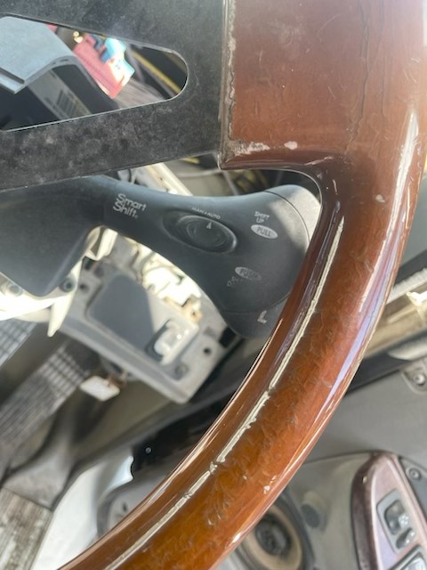

    So the mechanic has resoldered many of the connections of the back of the dash, and rewired ol mates dodgy electrical efforts. I now have a full set of dash lights, horn, indicators and hazards. Also shouted it a new set of brake switches as they were looking a little brittle or broken. I conformed the motor actually was a 12.7 and pulled the trigger on an in frame rebuild kit and exchange head as well after discovering the cog that makes the speedo count, removed. So speedo is off to be refurbished and recalibrated. All the tie rods, king pins, tie rod joints and steer bearings are fine, so ordered a set of parabolic springs and Koni oil filled shocks to match. Hopefully that will be part 1 to making a Kenworth cabover ride somewhat acceptable. Also ordered some new windscreen glass and rubbers. And advised the mechanic to put auto slack adjusters on while checking the brakes. So off to a good start I'm feeling.
    The donor Eaton has an Ultra shift like this which I think we can fit, but it does look a bit modern for the truck or expansive to fix.
    I prefer this type mounted just off the side of the tunnel or somewhere ergonomic for application. I will put the gear selector screen center of dash where the exhaust temp is. It's not working and been a failure from day one I hear.
