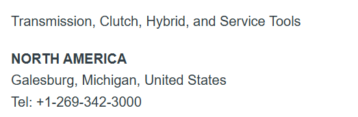

    I would call Eaton and ask for transmission tech support. They should be able to tell you if what you want to do is possible and what is needed.
    ROADRANGER HELP LINE: 1-800-826-4357
    UltraShift PLUS and SmartAdvantage 2,3
