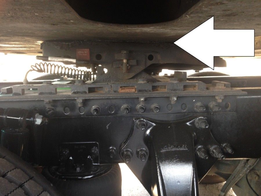

    There are no stupid questions.. B693A0AC-38CD-471A-ADBF-CFC8B519300D.jpeg this is the bottom of the trailer and the fifth wheel. Where the arrow points is where they want you to be sure there is no gap.

    Learn something every day. Never thought much about it. Trailer apron is the upper plate. Good info.
