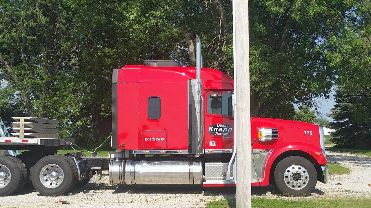

    Well, I topped off my 25 gal gas tank on the RV lane at Flying J a few hours ago, so I got about 100 hours of runtime before I need to worry about it again.
    Also, I figured out that the ducting did not seal properly how I mounted this AC. So the cold air was leaking into the intake air and vice versa. I got that sealed up and it is absolutely blowing icicles now. bring on the heat !

    oh, and I don't think my setup looks too shabby either. There was always 2 items of contention with commercial APU owners vs. guys with gas gen setups.
    1. looks, I was accused of having a "cobbled together" setup on my old truck. It didn't bother me per say, I certainly wasn't entering it in any truck shows.
    2. Having to carry gas cans. I really didn't mind the cans. I am always ready to stretch my legs when I park anyway, so walking to the gas pumps is fine.
    But on this truck, I wanted to show that you can have a pretty nice looking setup, and since I may have this truck for 10 or more years it was not hard to justify the aux fuel tank. I do have to bobtail to RV lane or gas pumps once a week or so, but it's a little something for guys who don't want to carry cans.

    ".... I don't think my setup looks too shabby either..."
    UNDERSTATE Much...? Coolest looking auxiliary fuel tank I'VE ever seen.....

    Dam it. Thanks for posting these. Again. Now you guys have me looking at extending this upcoming week's work I'm already doing on my 99 Century to do a proper inside install of the portable a/c setup with the 2000W Honda that came out of the 04 I got rid of. Still really liking that fuel tank setup Danny did. I could probably get that 25 gal reefer tank back from the guy that swapped me to a 50 gal on my trailer a few months ago when I had the reefer unit changed out LOL.
