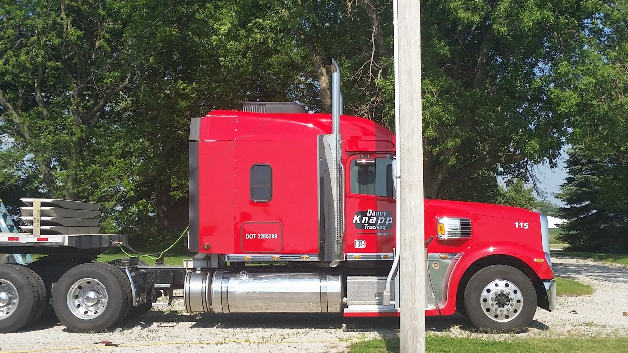

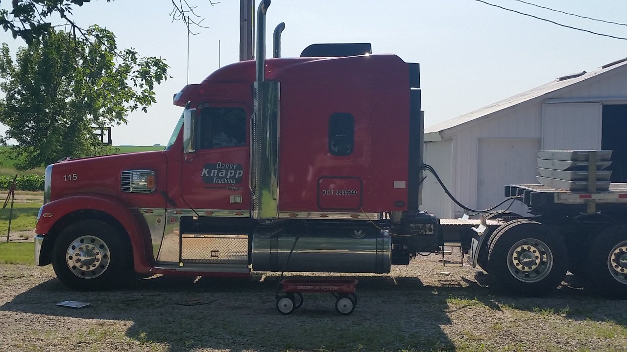

    Honda gen on driver side, auxiliary gas tank on passenger side, Coleman Mach 8 roofmount AC. I'm still not quite done tidying up wires. I will have a powered 6 way in the cab and Genius battery charger/tender hooked up full time as well.

    You need some half fenders my friend
