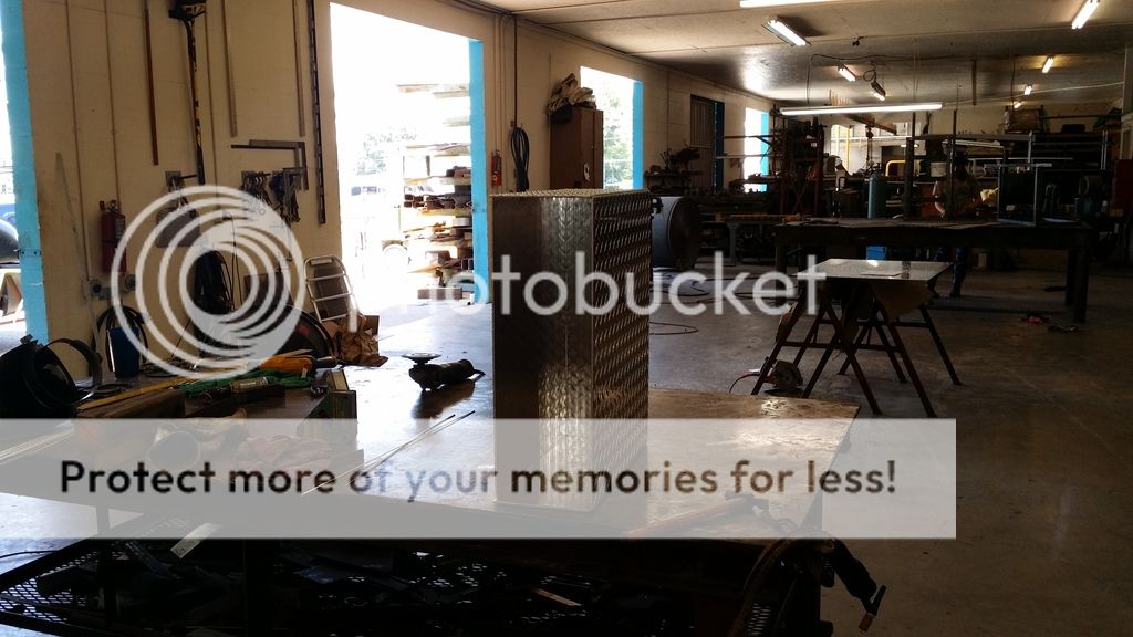

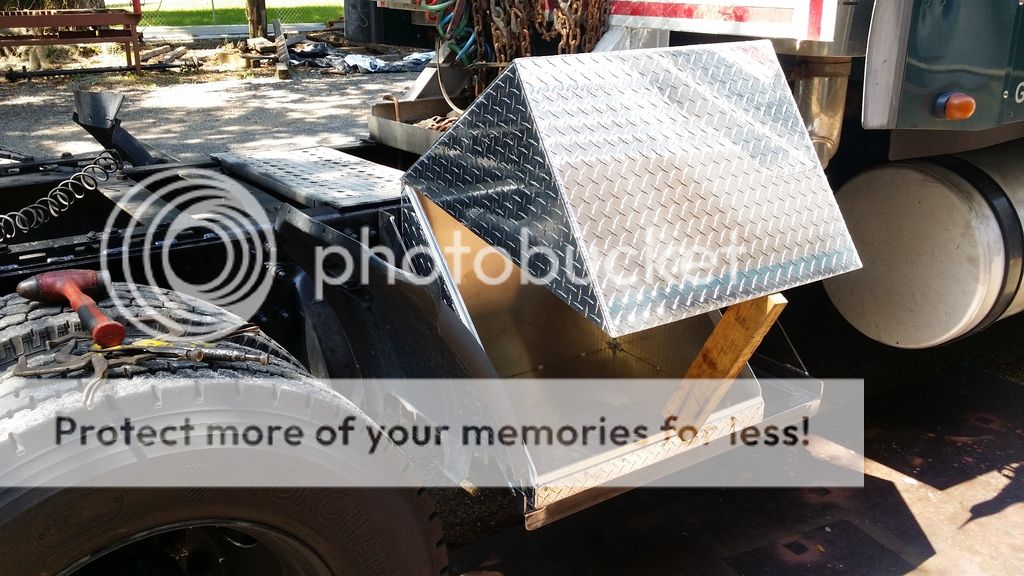

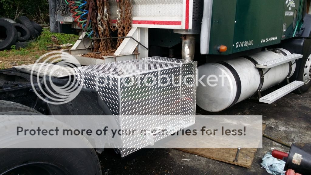

    Finally some progress on my generator set up.
    He was still sizing up the mount on the frame when I took these pics. The boxes are almost done,.. just some minor things and they will be complete.
    The main generator box will have hydraulic arms and notches in the sleeve so the box can be held open like it is now for normal ventilated operation of the generator like it is in the pics,.. or fully up right so I can service the generator.
    The smaller box is for the fuel cans. It will have a removable shelf in the middle for two 2.5 gal plastic cans and a door opening on the front. It will fit in front of the generator box.
    Hurst

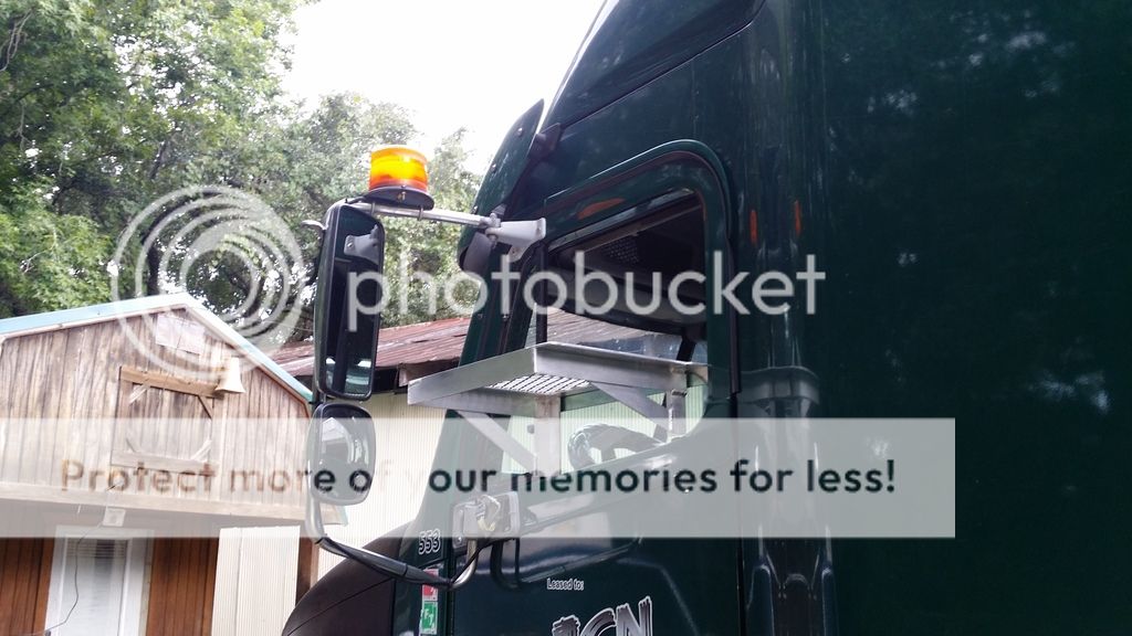

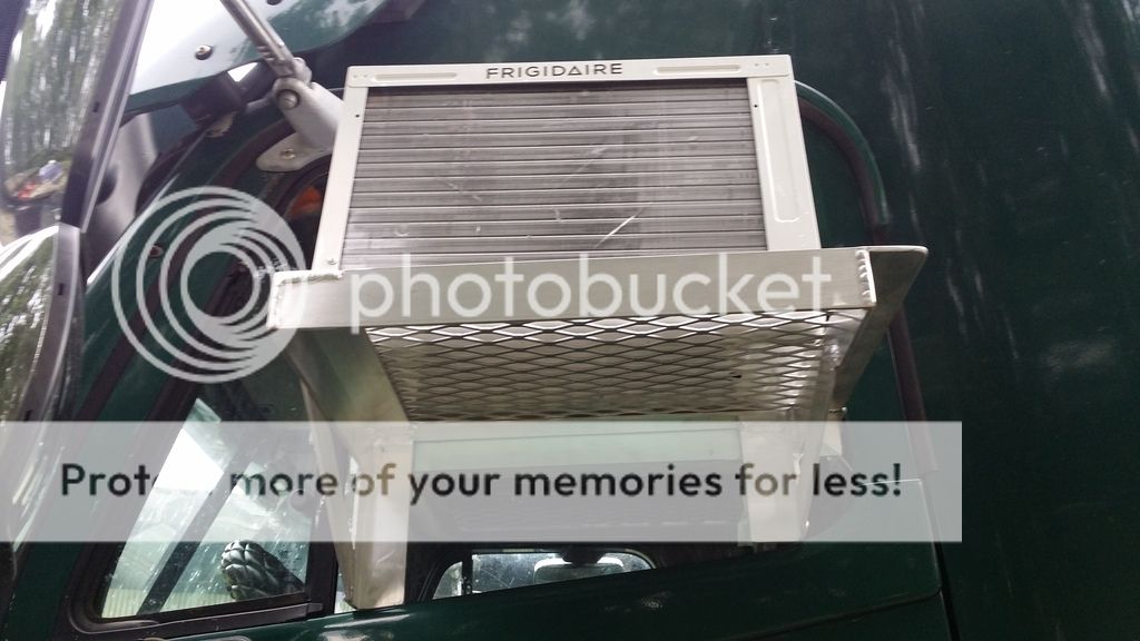

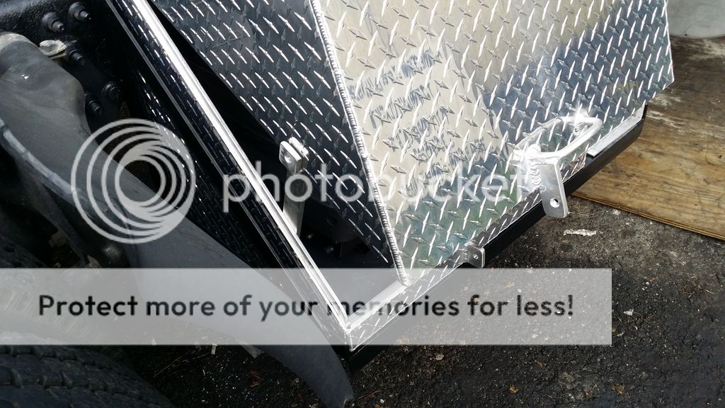

    Some update pics for mine. I'm at the 95% mark on my set up. Just gotta get some of those pads for the bottom of the fuel box, get a leveling block for the window rack so the AC sits level with a slight tilt toward outside. Get some pad locks and I can call it a day!
    This is how it will be all closed up.
    This is the arm to hold the box open while its running. I can put a pad lock in this position, go in and get a shower and come back to a nice cool truck.
    Then fully open so I can check oil and service it if I need.
    This is the window AC and the shelf mount.

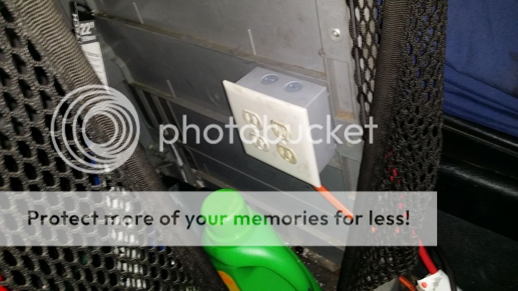

    4 way outlet wired off the 30amp, inside the bottom cabinet.
    There ya have it. If you guys can afford it,.. I highly recommend the Honda EU3000IS. Its so smooth and quiet,.. you have no idea its on while inside the sleeper. Its so much quieter than I thought it would be. Anyone who has one can back me up on this,.. its probably 75% quieter than any diesel APU out there today.
    The truck had been baking in the hot Fla sun,.. humidity was above 75%,.. I was drenched in sweat. Cranked up the generator,.. set the AC down to 65. It had the sleeper chilly inside of 10 - 15 mins. I laid down in the bunk and didnt want to get up. It was that nice and cool inside.
    Oh,.. and I tested it while in econo mode. Generator didnt even hickup,.. nice low idle with the AC cranking full blast.
