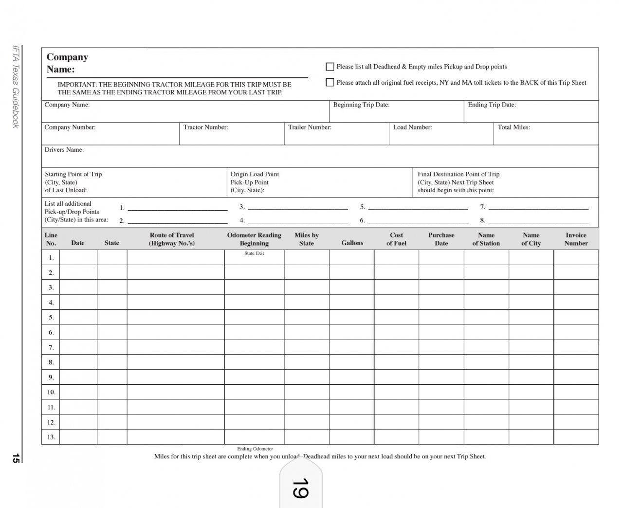

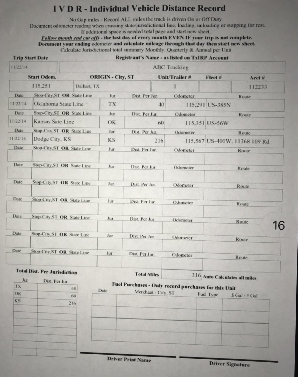

    I am currently doing my IFTA reports on paper. Your state should have an IFTA handbook on PDF file that should have samples for IVDR (Individual Vehicle Distance Record) and monthly/quarterly/yearly summaries for fuel and mileage. I use one IVDR sheet per load. I have customized my IVDR sheet so I am able to fit just about any long distance load in one sheet.
    The samples in the handbook are just “samples.” You can customize the format of the IVDR and summaries in the computer, but you want to make sure you are providing the information they need for an audit.
    These state handbooks are updated every few years, so their sample sheets have changed a bit. Most of the sample sheets ask for the same information with additional pieces of information.
    By the way, this same IVDR is sufficient to satisfy record keeping for NY, KY, NM, and OR. I must admit that the IVDR may be a bit redundant as our ELD logs may already have most, if not, all the information required. It’s just scattered all over the place. The IVDR and the fuel/mileage summaries keep it all in one place. Maybe in the future I will figure out a quicker way for IFTA/Mileage record keeping.

    Unfortunately, I think that safest way is to adhere to the handbook format and not to give them any kind of opportunity to fine you. So maybe what you are doing is the only proper way. I also have these templates ready in excel, just in case. I figure that data entering for one truck with a quarter worth of trip sheets should not take more than one afternoon of clerical workload, in a worst case scenario. Even though, I was not audited I know people who were and they were given some time to prepare and told for what period they were to be inspected. Maybe, it it best to call them (IFTA) and find out what their take is on the matter, knowing life though, they would give a vague answer and most likely refer me to the handbook.
