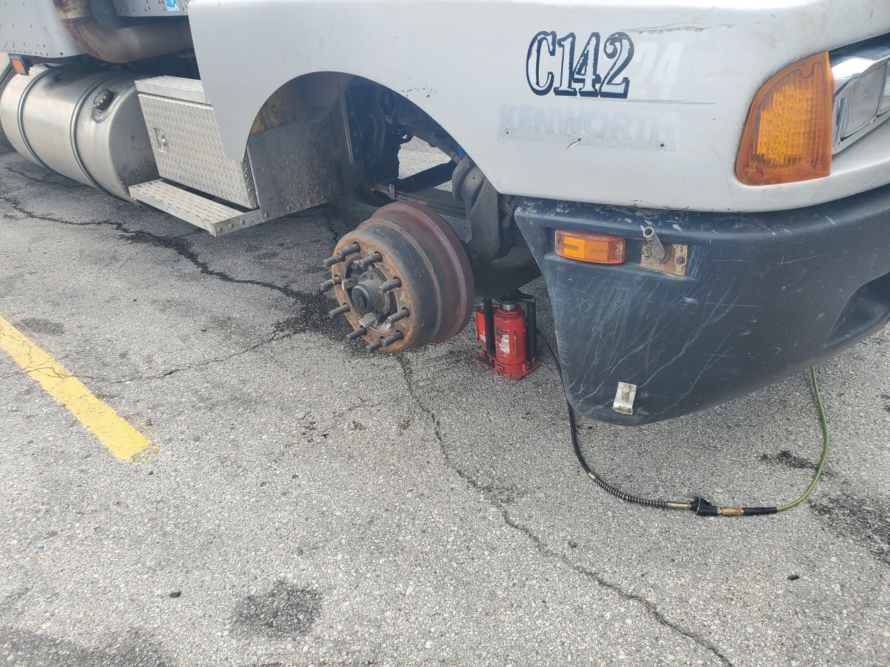

    Ahhhh, so THATS my problem, didnt have mounted spare...
    Battery is still full after reinstallation btw, torque wrench not pictured
    I saved 6 hrs and 20$ by having 1000$ of tools in the truck... but the loves still charged me 656$ for the new steer + mount/dismount...
