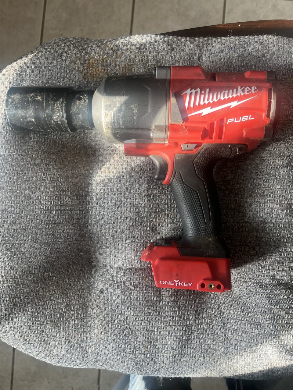

    Do the High output batteries make a difference?
    The impact came with 5.0ah, but I also have 8.0ah hight output, which I thought made a bit of a difference. But it might have been luck of the draw or all in my mind .
    Like a 12.0ah should do the same work as 2 x 6.0ah yeah?

    I'd have to double check but I'm pretty sure I just have 5 ah batteries on my 1/2 inch m18 fuel. And I've had no problem doing several wheels at a time. I double check torque after using impact and rarely get anything more out of the nuts.
    You are losing some power with an adapter

    I use my 5Ah batteries on mine. I have a 12 used mainly on a leaf blower, but never seen the need for it on the 3/4 impact.

    I have a 3/4 Milwaukee Impact I use for tires. Works good. If a shop over tightens then make sure you have some extra batteries ready for it.

    Just shows how bad shops over-tighten lug nuts. It's amazing there aren't more wheel off situations from stressed/stretched studs out here. That 3/4 M18 ought to bust one loose fairly easily without a whole lot of hammering if it's at 450-500 ft lbs.

    Yeah, the nuts I did up myself the m18 impact had absolutely no issues whatsoever taking off. But man these shops just keep hammering nuts way too much
    I think I will just take the m18 with me whenever going to a shop and use it myself to tighten the nuts.

    Had to swap all wheels over on 2 tractors today, I used the m18 for everything, no issues whatsoever, these nuts were not smashed on and whoever did it used some lubricant as well.

    OK just to finish this thread off, did 20 nuts today on 1 battery, 8.0ah high output, had 2 bars left at the end. I was using a 150mm extension bar and 3/4 inch socket no adapter.
    These nuts were put on by my regular shop who absolutely hammer them on, the m18 took a bit to get them off, but it was up to the challenge, so it did better than the air gun running from the truck.
    In my research I see the torque test channel rated the new 40v makita better then the m18, so if I was buying solely for the truck I would've got that, but we needed some gardening stuff around the house so the m18 suited that a bit better and I got the grease gun as well ( no 40v grease gun in makita yet)
    So yeah I am happy the purchase, still ran air from the truck though to pump up the tyres, but all in all a very happy chappy here.
