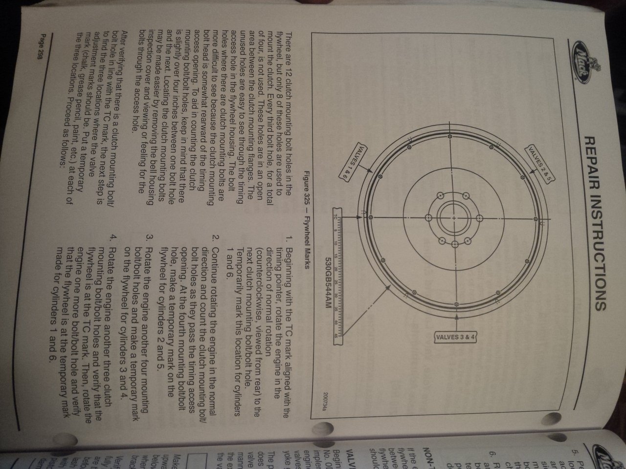

  5. BoxCarKidd
    BoxCarKidd Road Train Member
    4,598
    6,710
    Aug 26, 2014
    No problem only 7 and a half pages.
    The first 4 tell you there is a pointer in the center of the hole, at the bottom of the flywheel housing, after you remove the cover. Tool # J38587-A is used in the flywheel housing hole at the right rear of the oil pan to rotate the engine. The flywheels were marked at four places TC, valves 1&6, 3&4, 2&5. If you cannot read them there are instructions on here to remark them if you have a typical flywheel. If you have a non-typical flywheel it should be replaced.
    Then use the marks and adjust the valves the same as I explained in the companion cylinder method.
