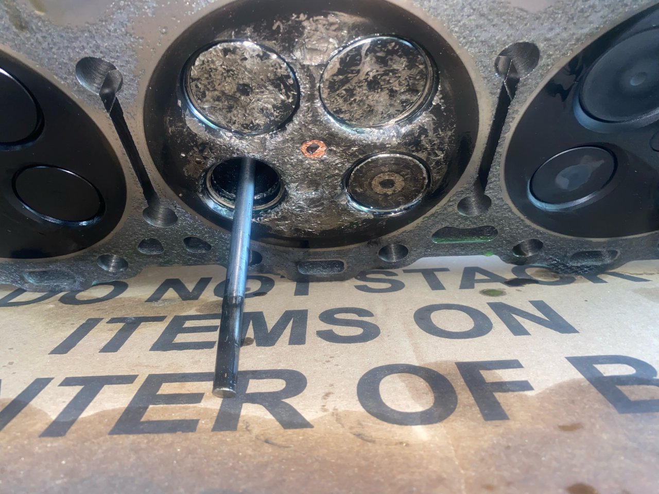

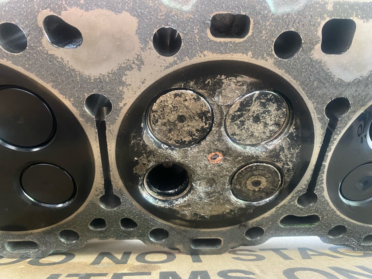

    So have done now three rebuilds on a Detroit 60 12.7 and have never had this happen before. The new heads we keep getting its like the valve head is un-welding. Is this common? Are we doing something wrong?

    you got pictures? cuz what you're saying doesn't make ay sense.

  5. ConfusedAF
    ConfusedAF Bobtail Member
    6
    1
    Jun 9, 2023
    this was after the first replacement sorry its the only photo i have to show

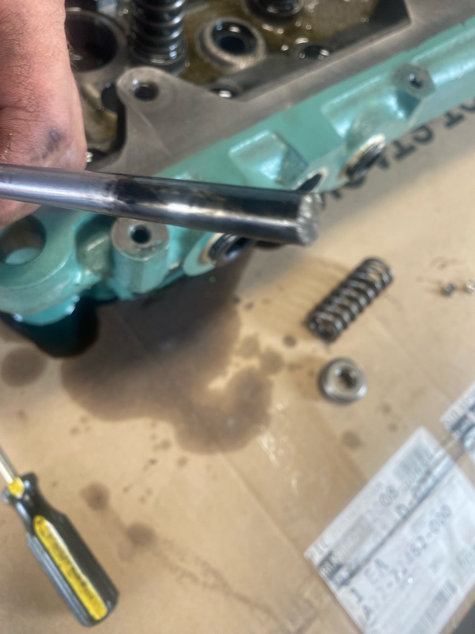

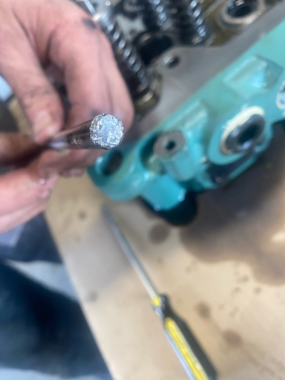

  6. ConfusedAF
    6
    1
    Jun 9, 2023
    These are from this second time

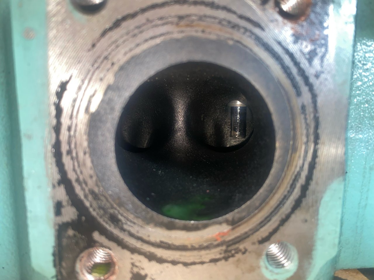

  7. ConfusedAF
    6
    1
    Jun 9, 2023
    second time
  8. buddyd157
    buddyd157 Road Train Member
    13,582
    34,899
    May 25, 2017
    under a shade tree
    well the valves are being snapped off the stems.
    either too much spring pressure, or very old valves you are using..???
  9. ConfusedAF
    6
    1
    Jun 9, 2023
    we got the head from a machine shop the first one i believe was a reman and this second one was supposed to be new
  10. Big Road Skateboard
    7,282
    41,505
    May 2, 2021
    Hows it running after firing up? May be out of time

  11. ConfusedAF
    6
    1
    Jun 9, 2023
    it was running fine did everything by the book driver even said it was running great until they heard a pop and back it came
