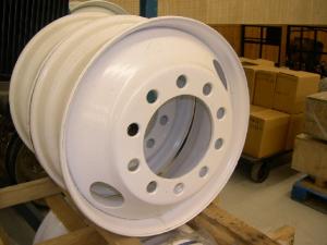

    Not sure what kind of wheels you have,but most 10 hole aluminum wheels look like this,generic Alcoa.Again clocked 180 so you know where the inside valve is and also makes a little better balance.

    i guessing he has steel rims witch only have two holes
