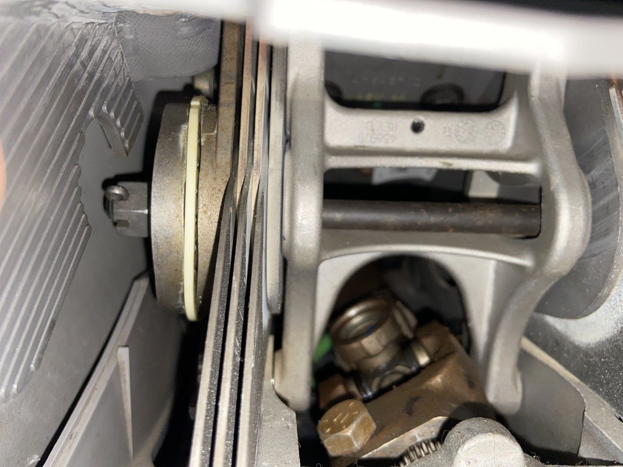

    No I didn’t do it. I opened everything on the dash but counting open gear shifter and the steering wheel as well. So i postponed my plan until I get a reply from you. I understand gear lever now but can plz tell me which screw I should remove to take the steering wheel off and do i have to remove the driver’s seat as well. Is it the big screw running across.
