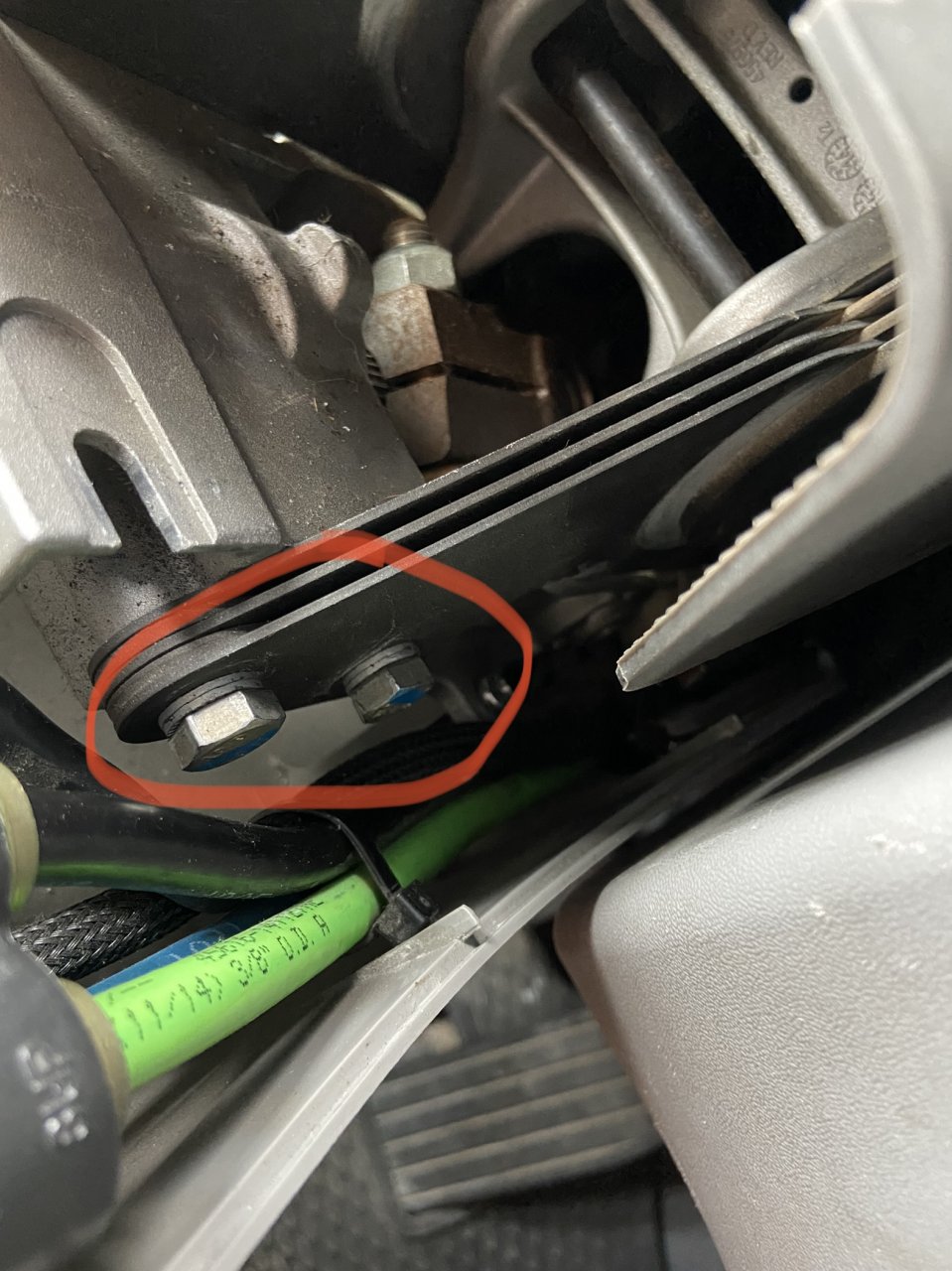

    I guess this long bolt attach the steering column to the frame. I am attaching a picture of the bolt let me know if am right ?

    Nope, Dont mess with that, its the tilt.
    Should be 6 bolts/ Nuts 3 on each side. 15mm socket?

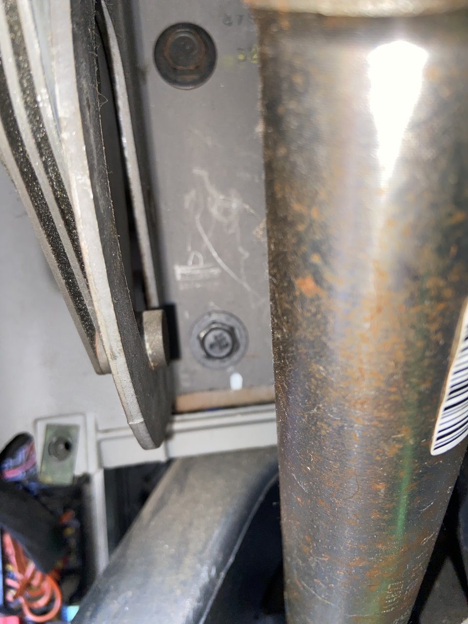

    I can see just these two bolt on the both side. 4 in total. They are 13mm. But even these do not move steering whee down. There is a hydraulic arm back there that wont let steel wheel down. I am attaching picture

    I guess you were talking about them. Image attached.

    Thank you so much sir. I have fixed it and reassembled the dash again. This was 2nd and the biggest job I have done with your help. I just replaced a alternator before. Thank you for replying to my very silly question. I saved around $2000 and 3 or 4 days of downtime. I did this on my day off. It all have been possible because of you. Thank you..!
