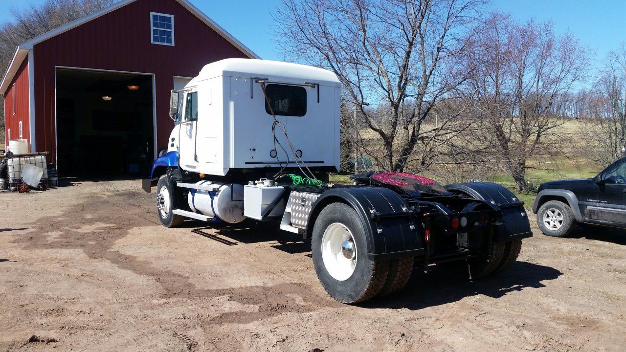

  9. HopeOverMope
    HopeOverMope Road Train Member
    1,801
    3,211
    Feb 25, 2016
    I-20 LOUISIANA
    Man that truck is fresh! Cool truck
