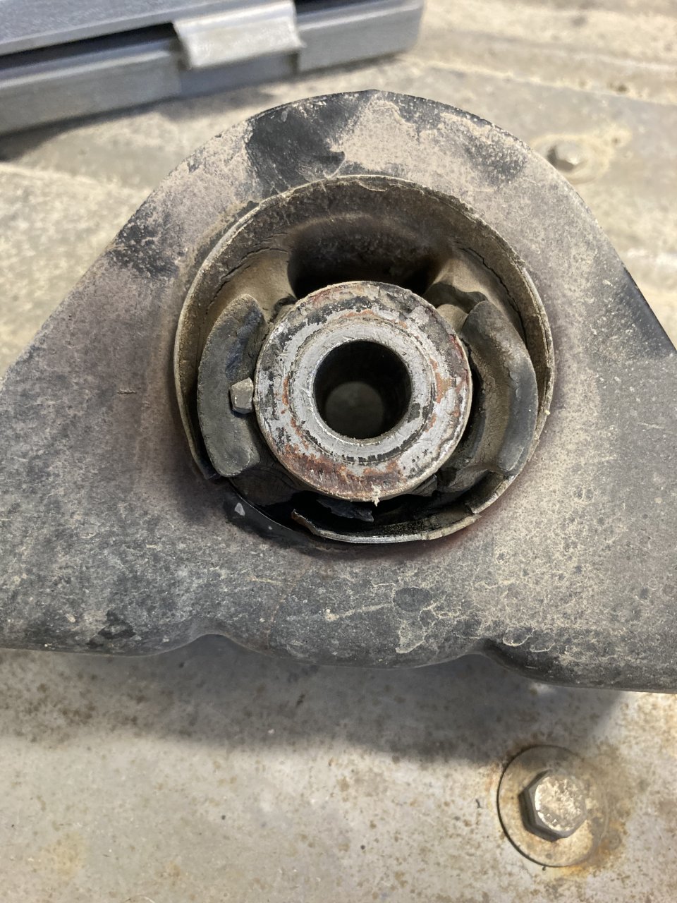

  3. uncleal13
    uncleal13 Road Train Member
    3,797
    6,299
    Apr 9, 2009
    Humboldt, Sk
    Mine turned out to be the cab mounts. One on driver side was crushed, passenger side was mostly gone.
