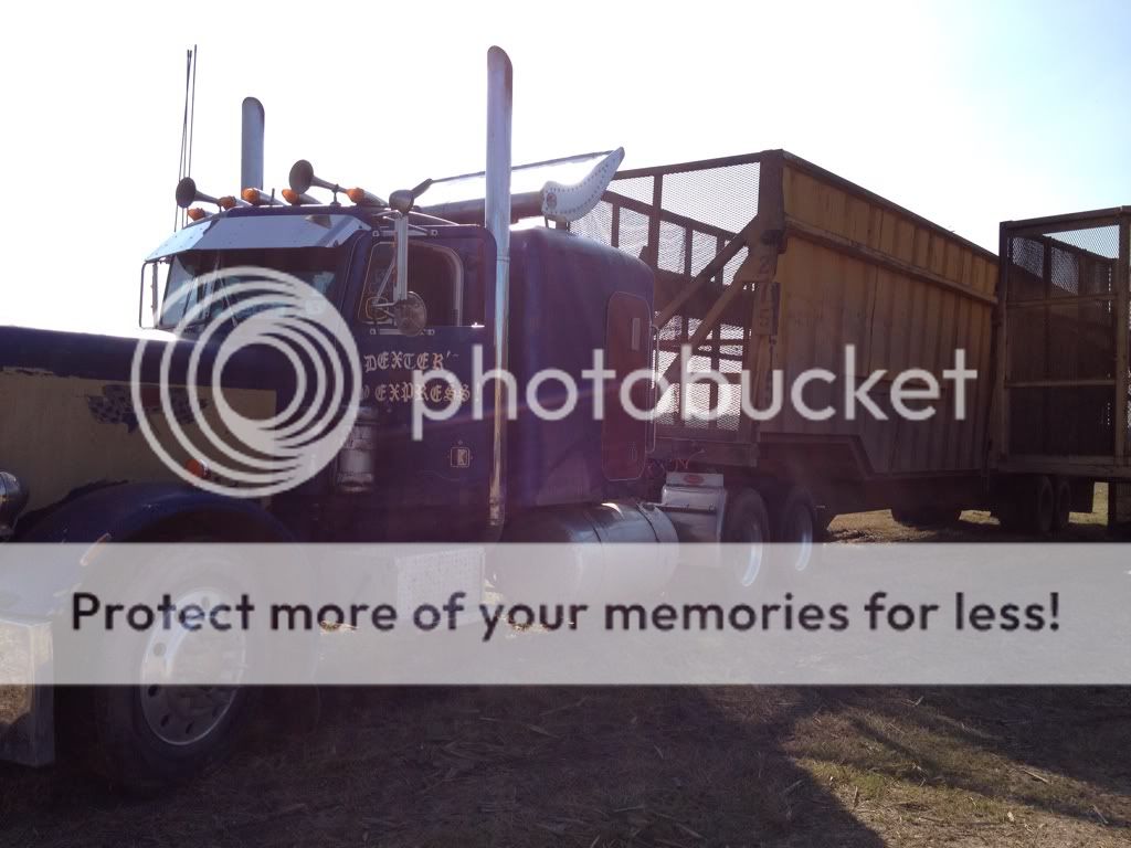

    Gotta love the 359's!!! Here's pics of my truck I've been having awhile other than the Werner company truck
