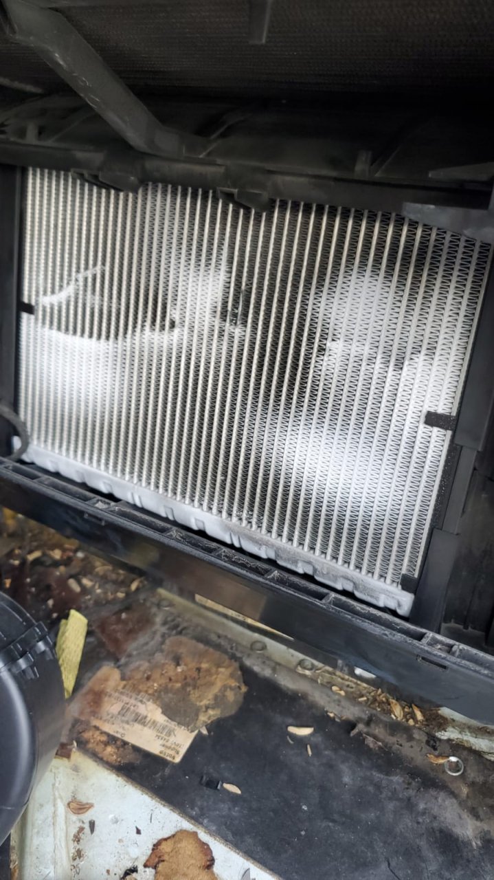

    it freezes pretty good look at my pictures....when I drive ac works fine for 30 minutes...then no air is coming from the vents any more ...hot or cold ...but I hear the in cabin fan working. that's why I took the cover off and see what happens. now ..when I stop...turn the engine off ...start it in 30 minutes ...do not drive ..just run the engine ...AC works fine. someone told me I have faulty control switch that shuts the vents off...well we will see what will happen with covers off ...kinda bypassing the vents ...cold air will be blown directly by the fan into the cabin ...IF the air is warm then I know my AC is the problem.
