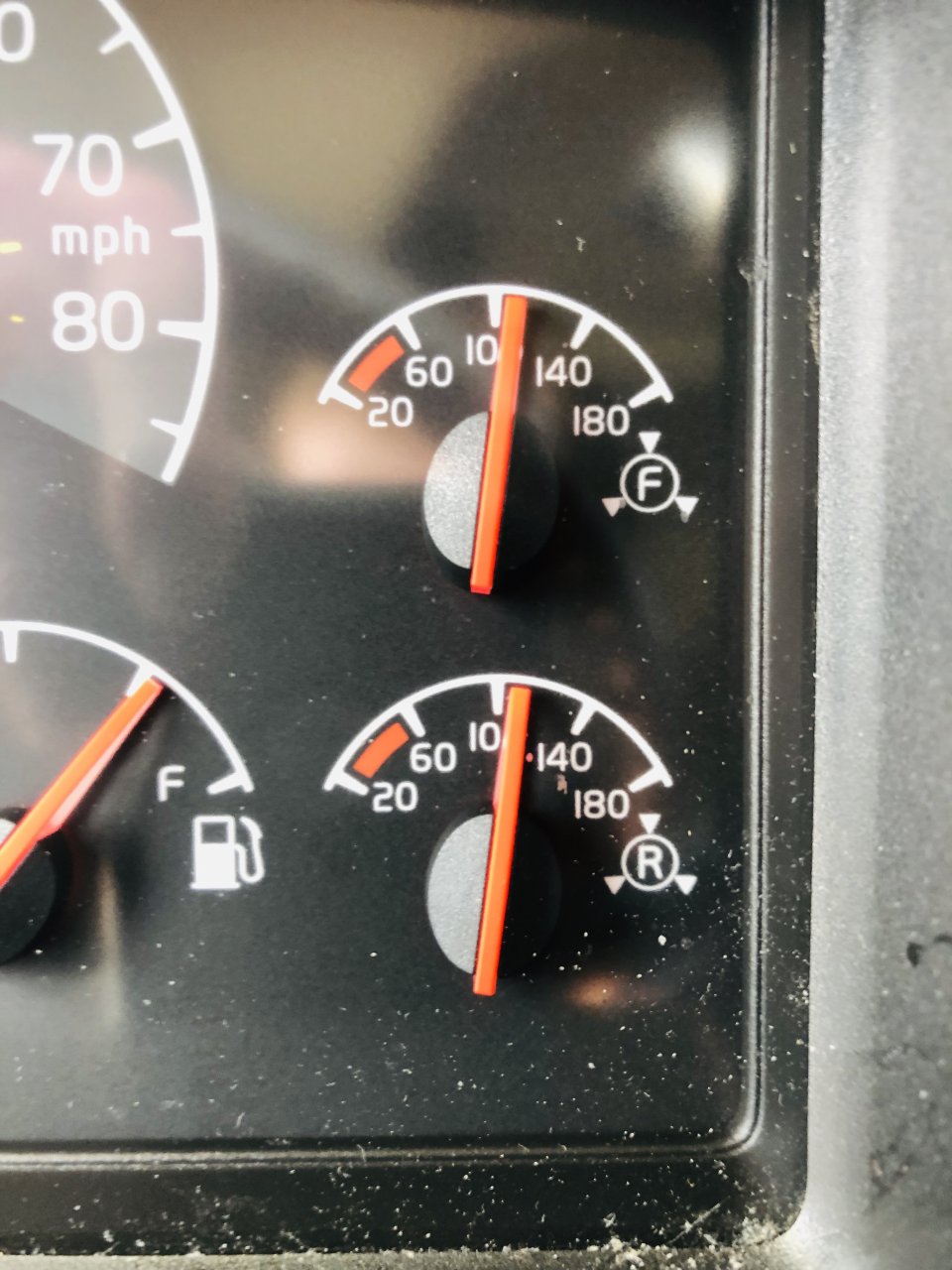

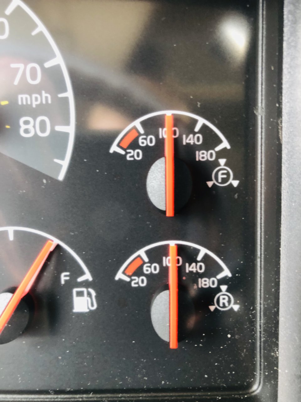

    Hi there, could you let me know how did you fix that 1st problem? Mine is same issue happened, I replaced air tank sensor and new air dryer. But still early purging around 100psi. 2 gauges show always 80-90psi while driving. Rear air bags are empty while driving. After pulling over all raised up. I’m confused
    My truck is 2017 VNL760
