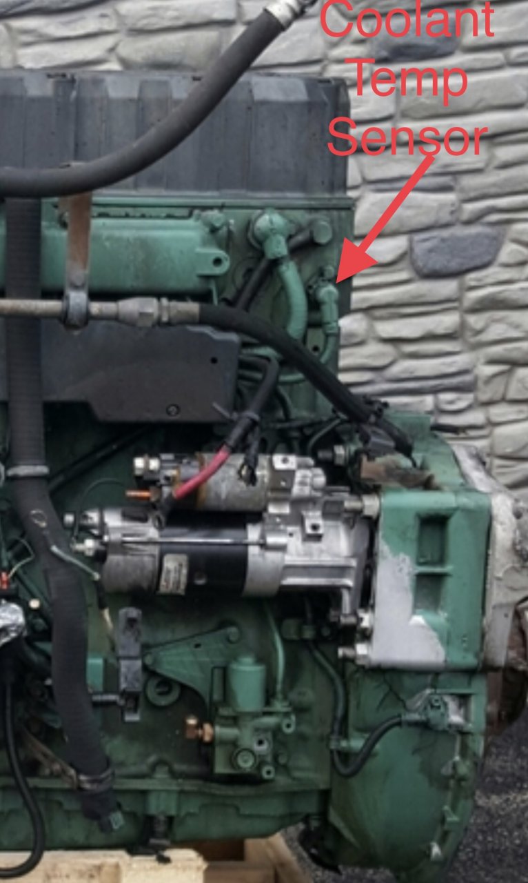

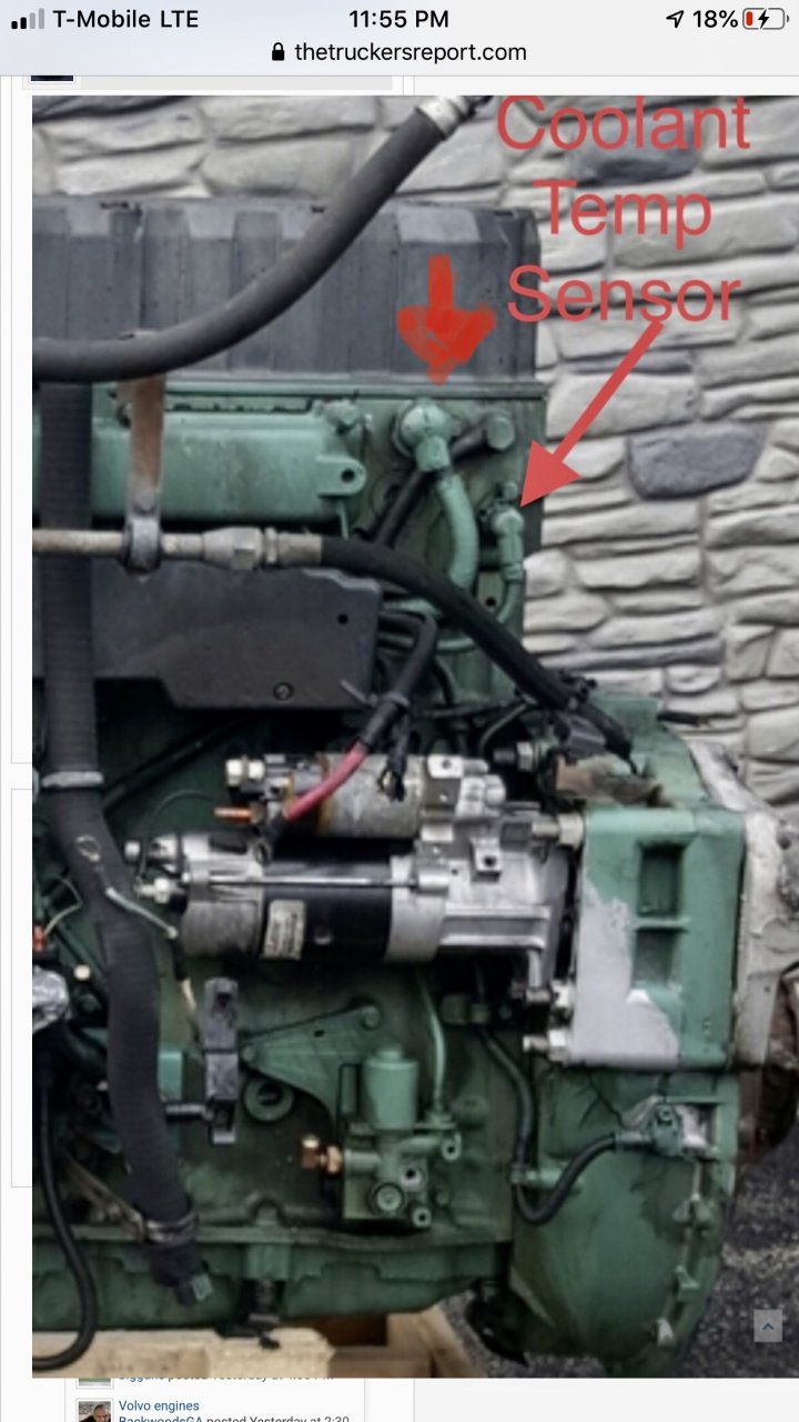

    Any one knows where is the coolant temperature located in a Volvo D 12 ? Thanks

    20576617 coolant temperature sensor
    949656 o-ring; 984736 screw that holds it down. Max torque 22 ft-lb.
