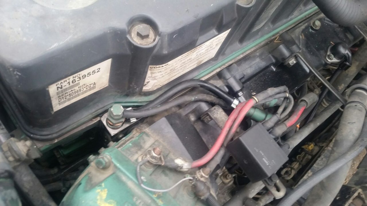

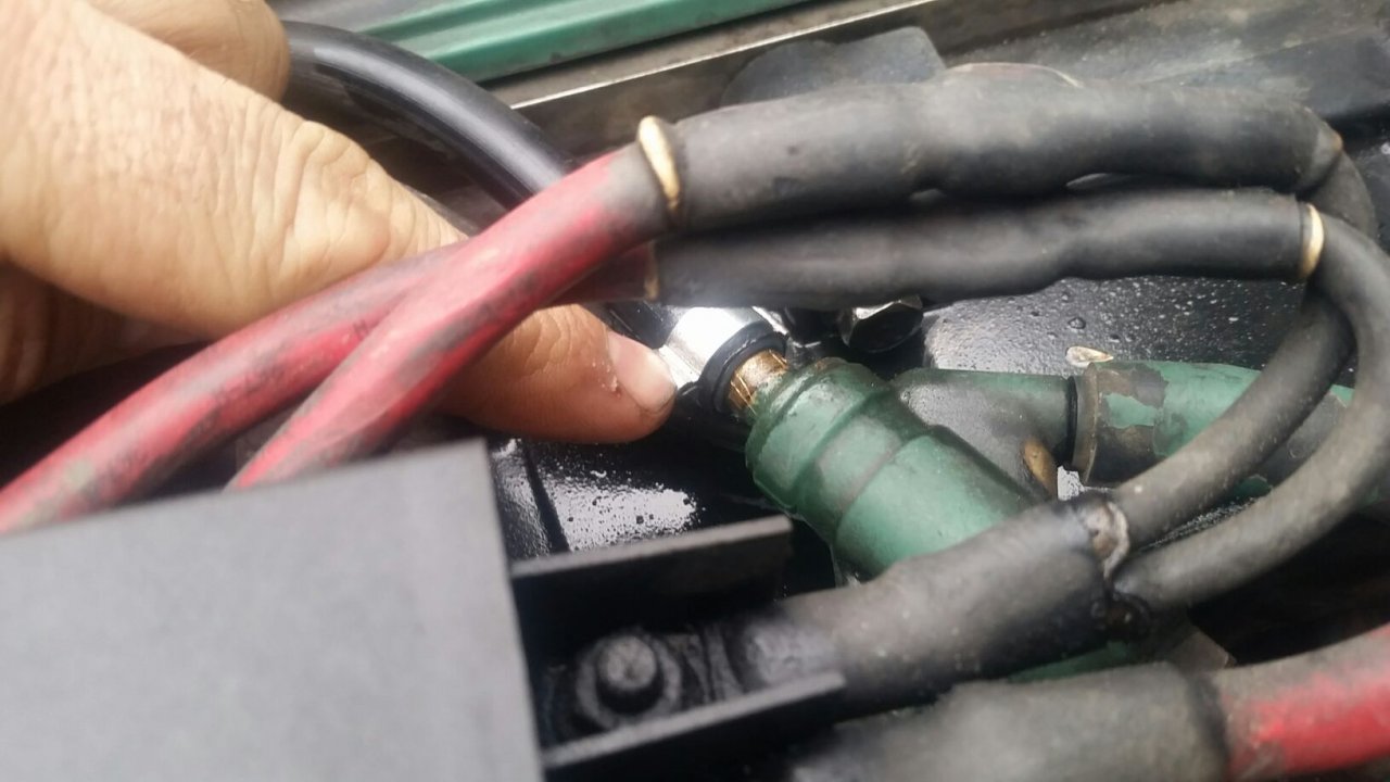

  6. dustinbrock
    dustinbrock Heavy Load Member
    Messages:
    883
    Thanks Received:
    371
    Joined:
    Apr 19, 2012
    Location:
    saskatoon,sk
    I had same problem on my 06 d12d. for me it was this lines clamp had worked loose and was dripping. had to prime each morning and ran like crap.
  7. dustinbrock
    Messages:
    883
    Thanks Received:
    371
    Joined:
    Apr 19, 2012
    Location:
    saskatoon,sk
    Follow your fuel lines and look for damp spots. is your fuel filter damp?
