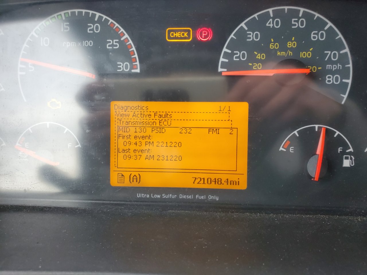

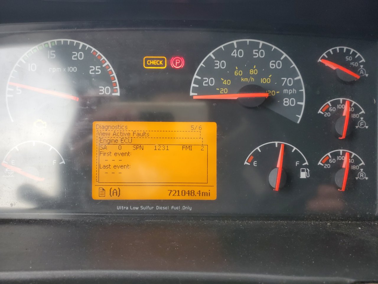

    While I was driving a got a bunch of codes with message for engine derate in <60 mins.Gauge from DEF went down. I made it to delivery with msg engine will derate at next truck stop. Last year I installed new batteries, rail and new battery kill switch. We checked battery connections, ground connections, cab and PDM fuses, DEF fuse, engine ECU connection, DEF connection, we tried different DEF ACM, checked all for corrosion and they all have voltage. Nothing has worked, still same codes except that code for transmission is gone. This is list of codes
    MID 144 PSID 230 FMI 5
    MID 130 PSID 232 FMI 2
    SPN 5246 FMI 0
    SPN 641 FMI 9
    SPN 3216 FMI 9
    SPN 3226 FMI 9
    SPN 1231 FMI 2
    SPN 1231 FMI 9
    Anyone has any ideas what to check next?

    We tried that, all codes except transmission are coming back
