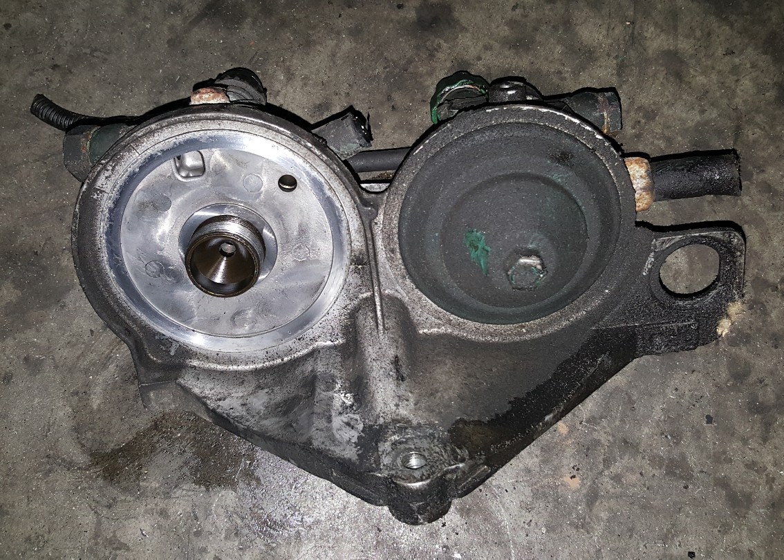

    Have you done any repairs, right before this symptoms showed up? or PM/oil fuel filters replacement?
    I got a similar problem years ago on my last truck with D13, after a PM oil change at TA in Georgia.
    When the technicians removed the fuel filter, it came out with this threaded section/ pipe , which was supposed to stay on filter housing . They told me they heard something falling in oil drain , but couldn't find what was. It was the piece i encircled in red bellow,( just a random volvo pdf, but it's same on D13) , this hexagonal part, it's like a bullet ,inside the fuel flow , regulates the fuel pressure, with its weight i believe, gravitational . So, they installed the filter without it, i got same symptoms as you describe, i bob tailed to Atlanta slowly 45 mph, low fuel pressure warning, and paid 1000$ for a new housing. I knew i need that piece only, but Volvo don't sell it, should be available for 2$, spare in any lube shops authorized to do oil changes for Volvos, because it happened 6-7 times after to see the fuel filter coming out with that threaded mounting pipe, but i pay attention and tell them.
    Just some thoughts from my bad experiences.
    I found a photo;

    No it just happend out the blue I did a load for the day then I tried to do another one trucks starts to hesitate like it’s struggling then a check fuel filter light comes on which I change and it still does the same think
