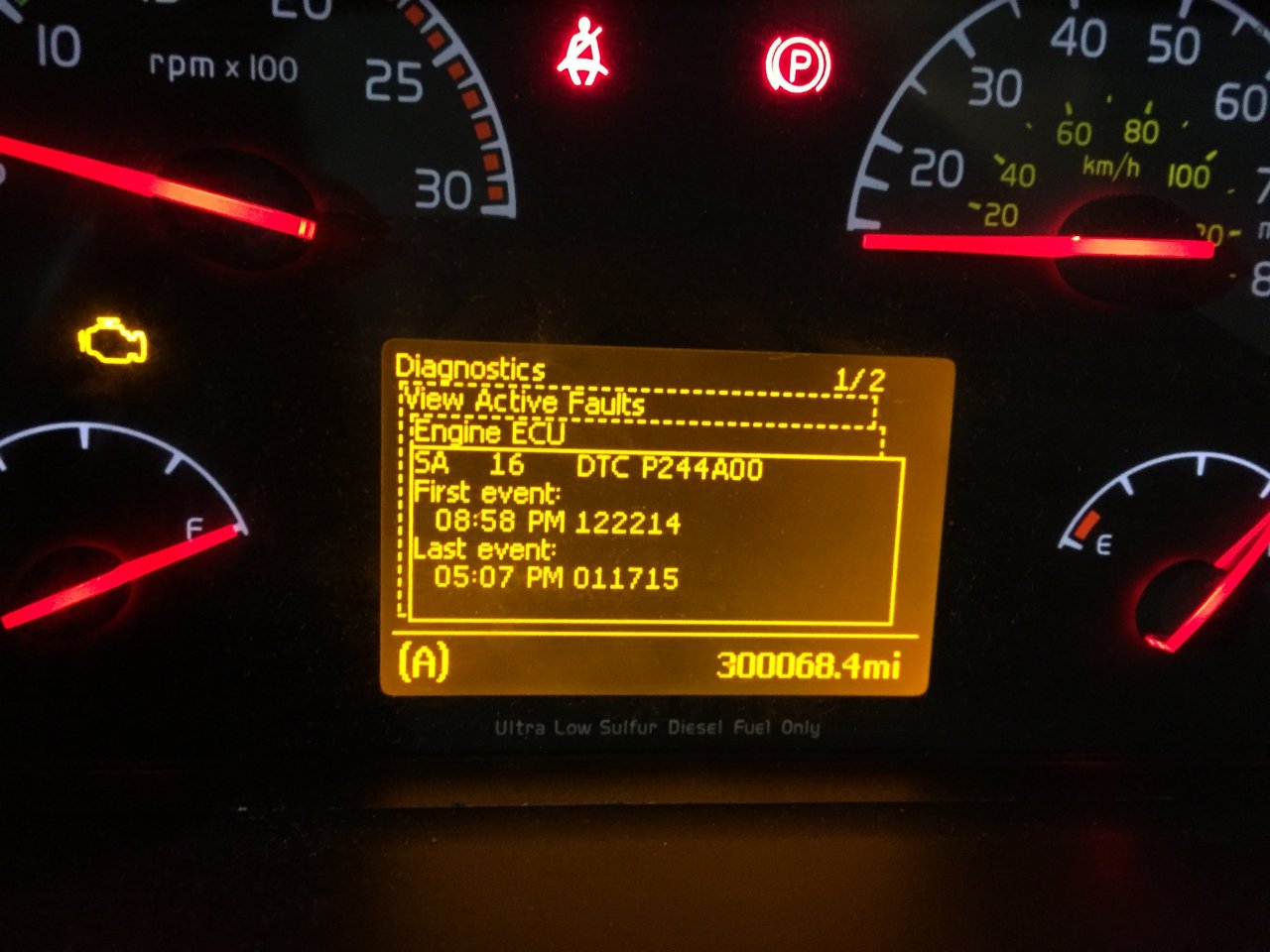

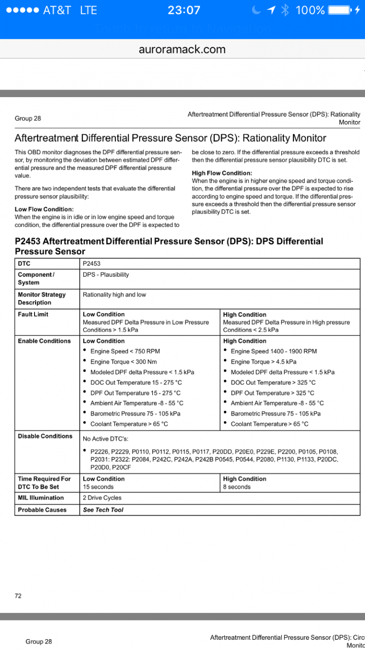

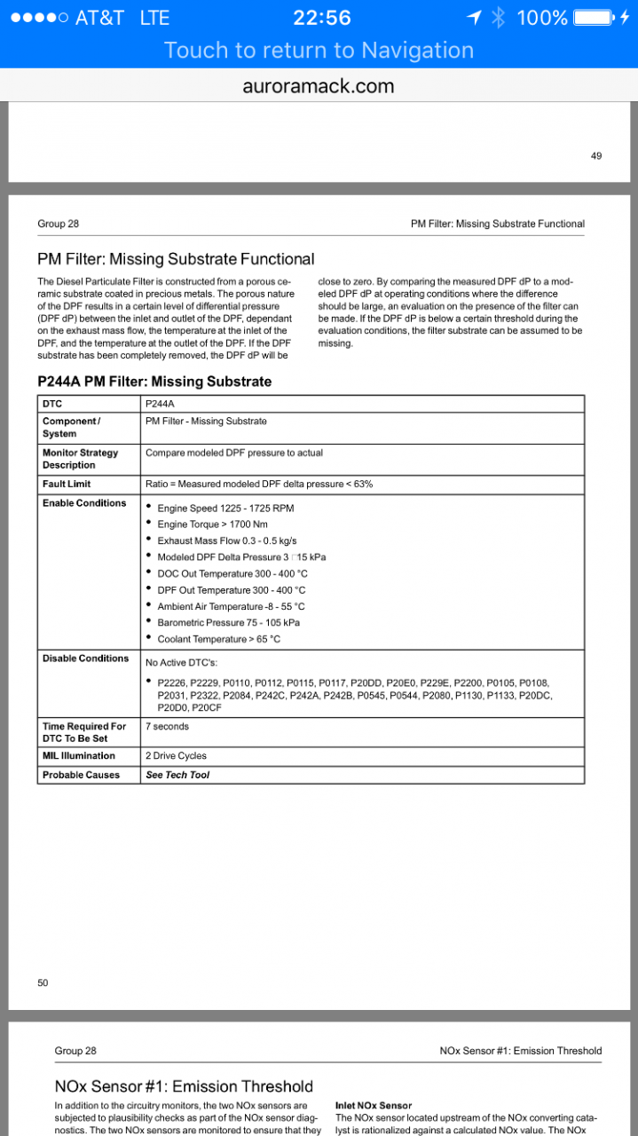

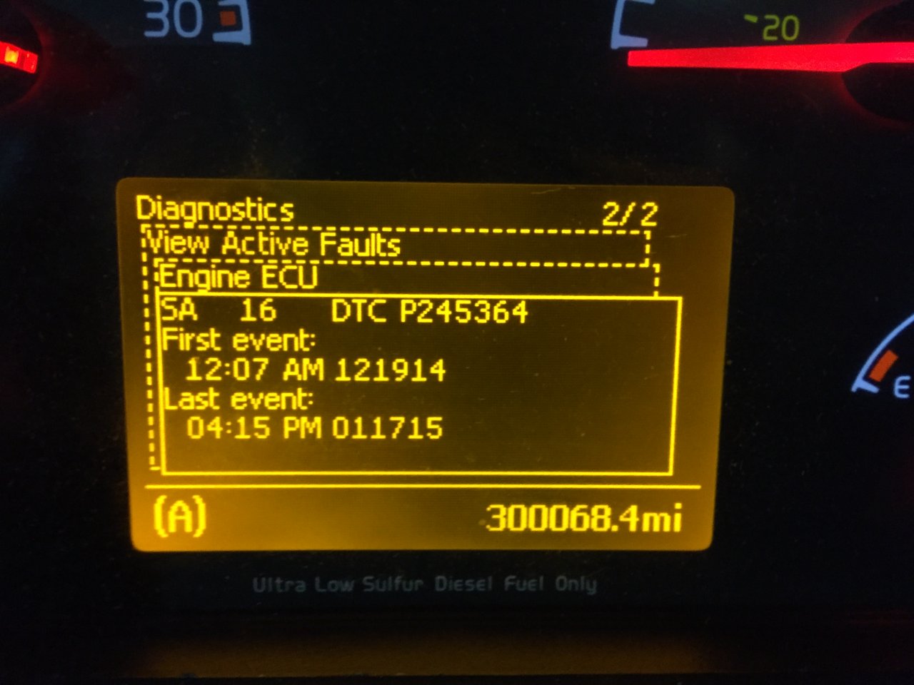

    I think my DPF differential pressure sensor is out. What do you guys think?
