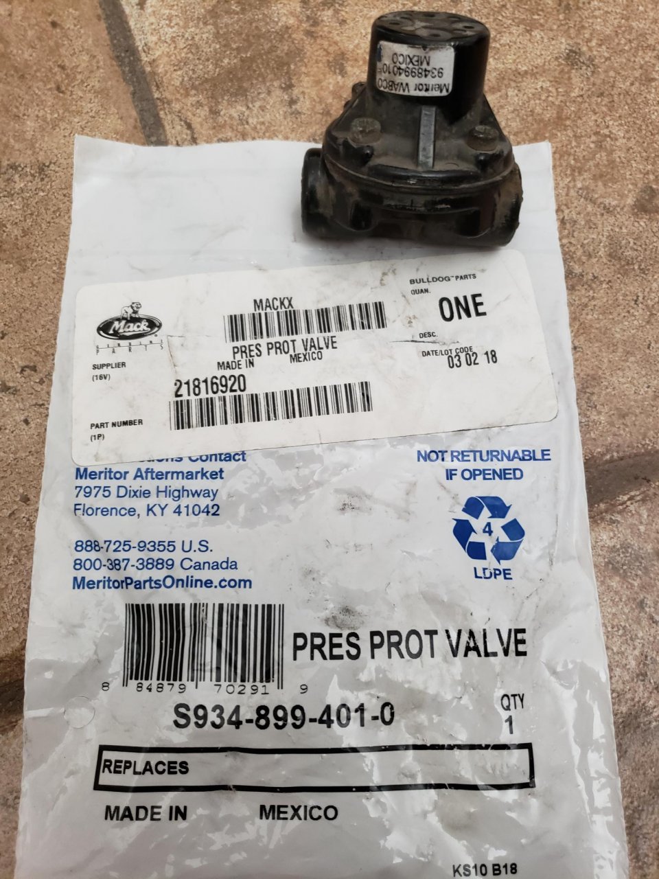

    Hey Nas I am assuming that this pin hole is not suppose to be blowing air? When aired up it has a pretty good amount of air coming out and when shut off it just keeps leaking air until the tank is empty. Is it rebuilable or just replace it? Hole in the side of the pressure regulator for the 4th air tank that is

    Is this the bottom valve you are talking about on auxiliary trans tank. If yes no it’s not supposed to leak not rebuildable better replace it.
